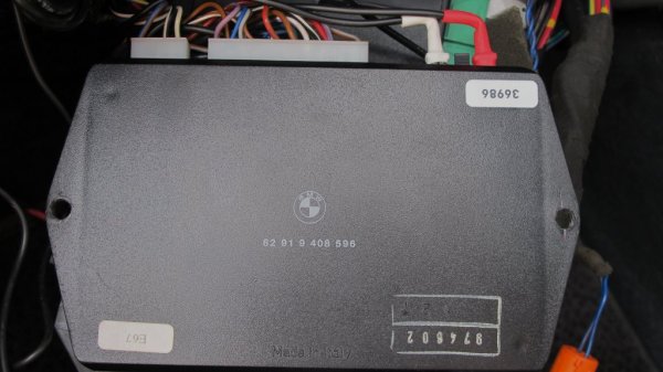

Attempted to re-programme a key fob (old `house brick' style) today, ironically using the guide that I wrote in 2013 and have used several times.
When I moved switch to learn position - alarm activated. I don't think I disturbed other wiring but a possibility.
Alarm is now permanently activated and I cannot reset. Have turned sounder off under bonnet but hazards still flash on timer.
Central locking still working and car will start ok. Run out of day-light so have given up and disconnected battery overnight.
Looking at ETM, it appears I can't simply pull a fuse without taking another circuit out. Can't work out which cable to pull on the box.
Any advice welcomed.
