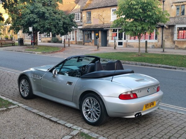

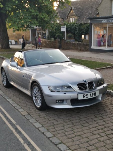

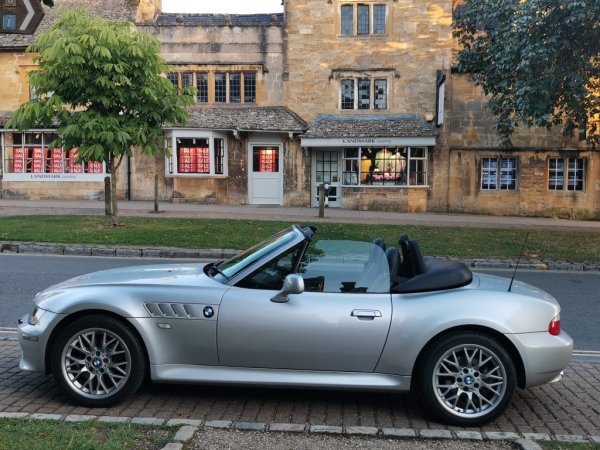

This week I took delivery Adrian’s stunning 3.0 Zed, this car is in fantastic condition so taking her apart has been a joy. She in for a whole host of work. Basically a full front to back overhaul of the main mechanical items. We don’t need to powdercoat due to everything being in such good condition.
bodywork is also brilliant
