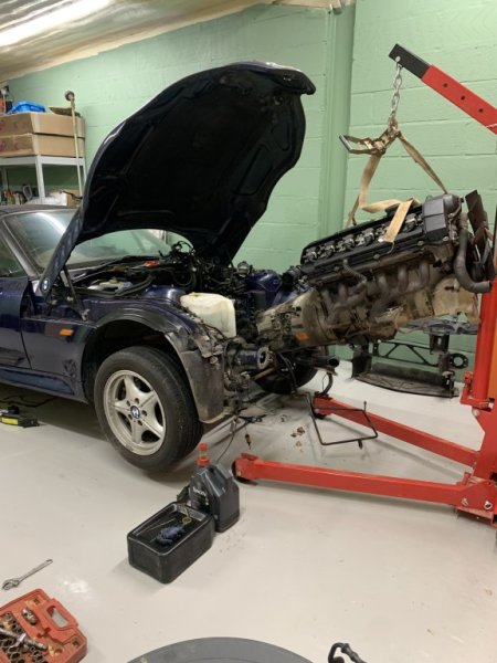

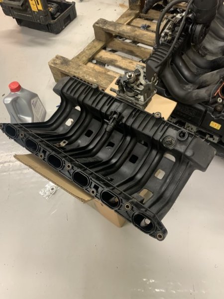

Not to be defeated, or the money to scrap and start again. I decided it was time to find a replacement engine….
Tomk
Mar 8, 2023
54

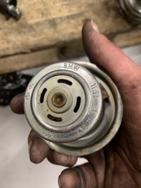

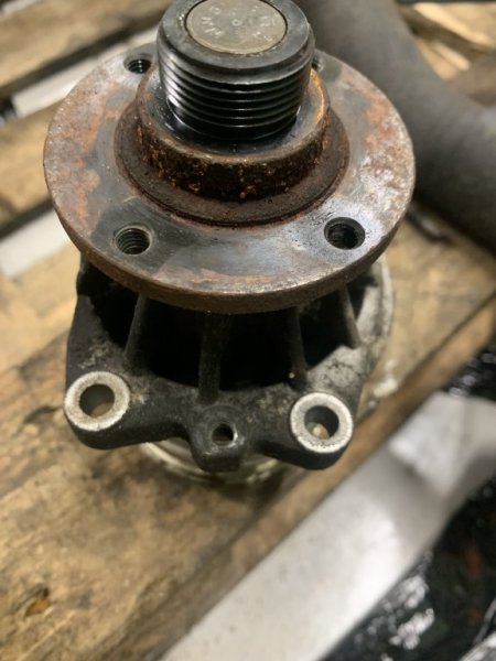

Swopping parts over concluded who ever had serviced this car hadn’t replaced a few bits. Reckon that might be the original thermostat. Not sure about water pump as it was a metal type.

Look at that lovely clean floor!
