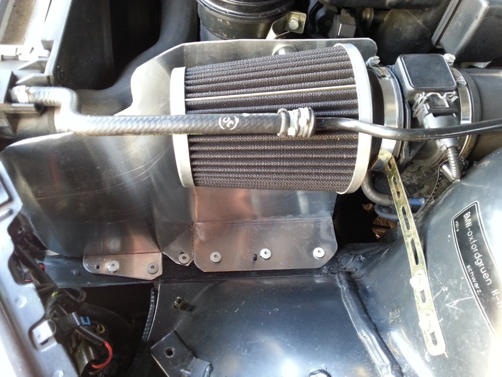

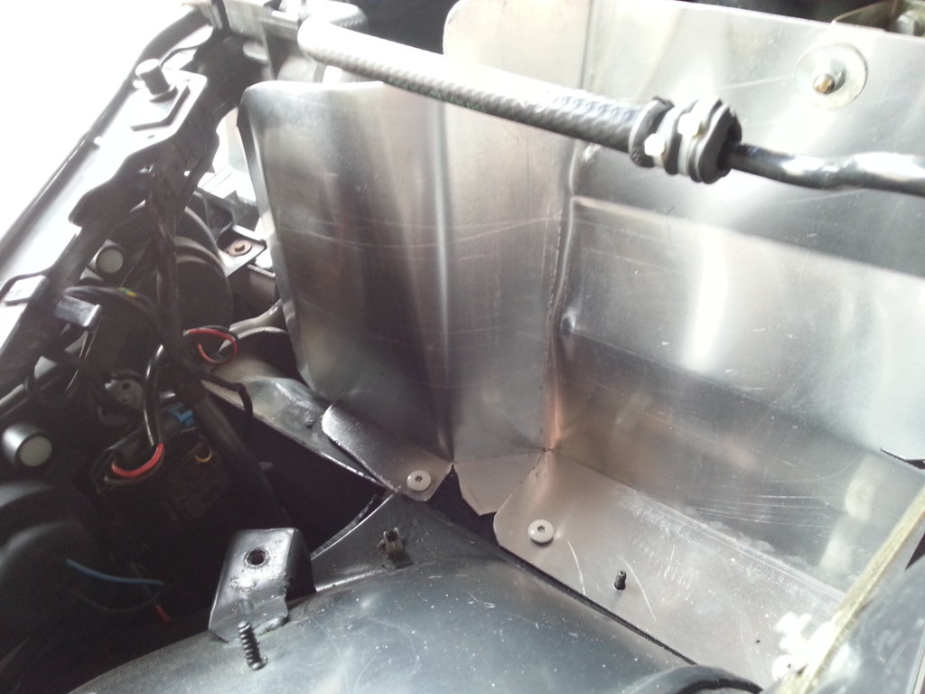

Having fitted an after market air filter I finally got around to making a cold air feed/heat shield for it this week and fitted it today.

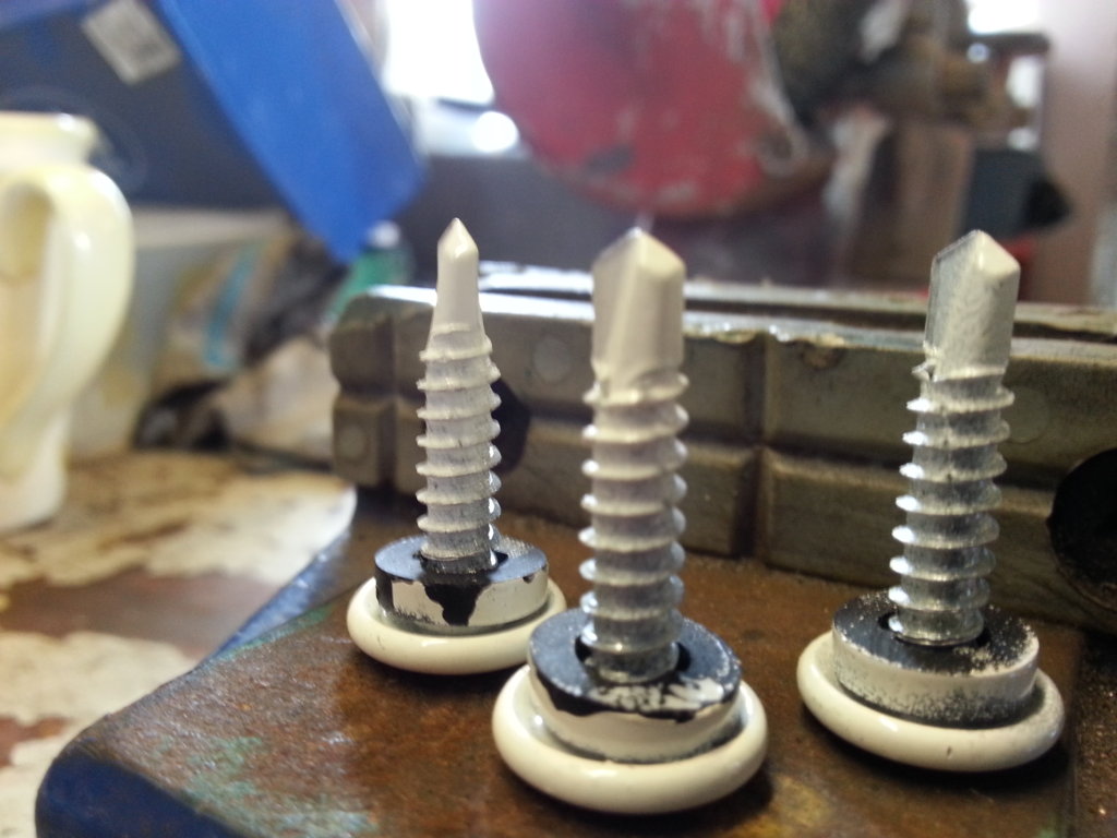

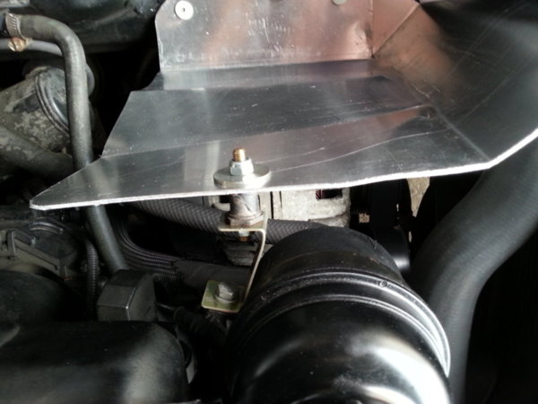

It's secured on the chassis by the self drilling screws shown and a short bracket fastened to the oil filter housing clamp by a small fuel pump mounting from a Renault ( shhh don't tell anyone) to stop vibration.
An upper section may be added or the side extended upwards to meet the underside of the bonnet.![008.jpg 008.jpg](https://zroadster.org/data/attachments/7/7132-31532f75bf5b0423a6e7668ff77031ab.jpg)
