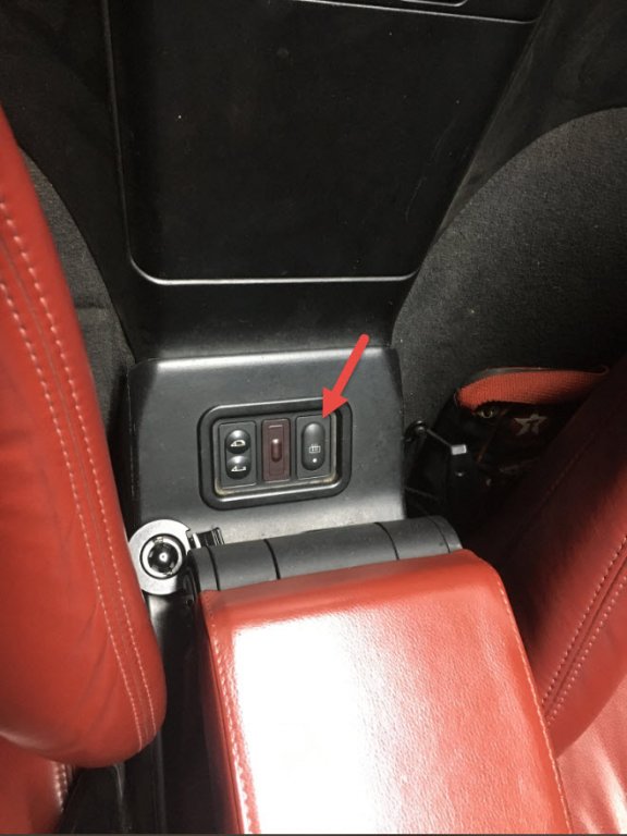

The main wiring for the switch will be found taped up behind here. If the car did not have a hardtop, there will be a blank in this position.

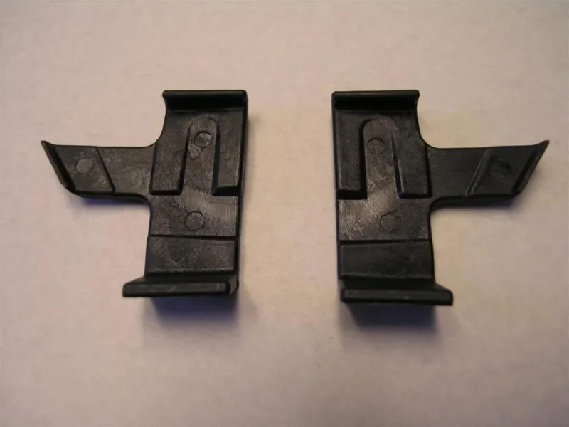

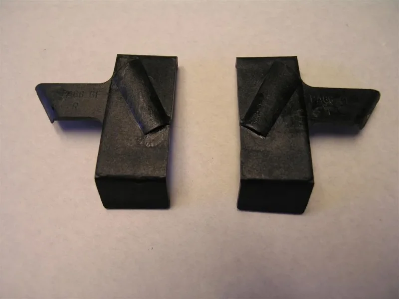

I've got a spare harness to connect the heated screen if you want it (message me and I'll chuck it in the post) and I would be incredibly interested in borrowing the little plastic spacers for aligning the top if you have actually managed to source those (I might have a go at creating a 3D printed version as well if I get my hands on some)
the thickness of the gauge not including the leg that apparently rests on the body panel is 6mm and including the leg is 12mm.

Yeah should do - as long as you have the right switch - being facelift it should be round like the picture above. Assuming you have an electric roof, the wiring that you connect at that end is all next to the harness up there so no need to pull carpets back etc. As mentioned above, at the switch end the wiring should be taped to the cross member under the black panel (which pulls out.
