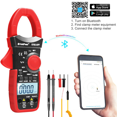

I recommend a clamp ammeter with bluetooth. Mine cost about £40.
Something like this...
Connect to the app via bluetooth and clamp it around either of the battery cables - I usually use the earth.
Test for parasitic drain. I usually do it by removing fuses one at a time, but you have to eliminate any circuits that are live when the fusebox is accessed (such as the bonnet alarm switch on the Z3).
Thanks Gary - that takes me back to my electrician days !
