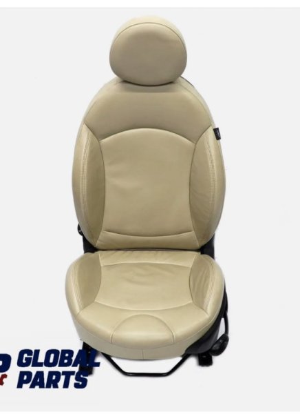

Has anyone tried to fit Mini R56 seats into their Z3 Rebody?These seats are available at 149EUR each from Ebay.
MGB seats would be preferred for me but it has proven to be next to impossible to find anyone from UK to ship these to mainland Europe at decent cost.

I have a Mini R56 sat outside, so can measure them for you if that helps?
If you can find some MG seats which need a lot of work, maybe ask the seller to remove the foam and just buy the seat frames? If you get GT seats they fold almost in half, so take very little room in a box. Would be a lot easier and cheaper to ship.

Just measured them.
The Mini seats are 540mm (ish) wide with foams attached and the MGB ones are around 460mm at the widest point, so think you will struggle to get the Mini ones to fit and be able to use the seatbelts.
I don't know the width of the Z3 seats as mine are long gone!

My original z3 seat cushion at the widest point is around 50cm Add the adjuster switch, trinket tray and plastic it's just around 54cm.
Widest point of the back is also 54 ish.

So they may well fit?!
Only thing is that the R56 seats aren't any more 'retro' than the originals IMO. In fact the earliest R56 was released just as the Z3 went out of production!
I’m sure @Pingu has Mini Mayfair black with cream piping seats in his. They actually look quite retro and suit the car well

From memory they’re something like this but black
