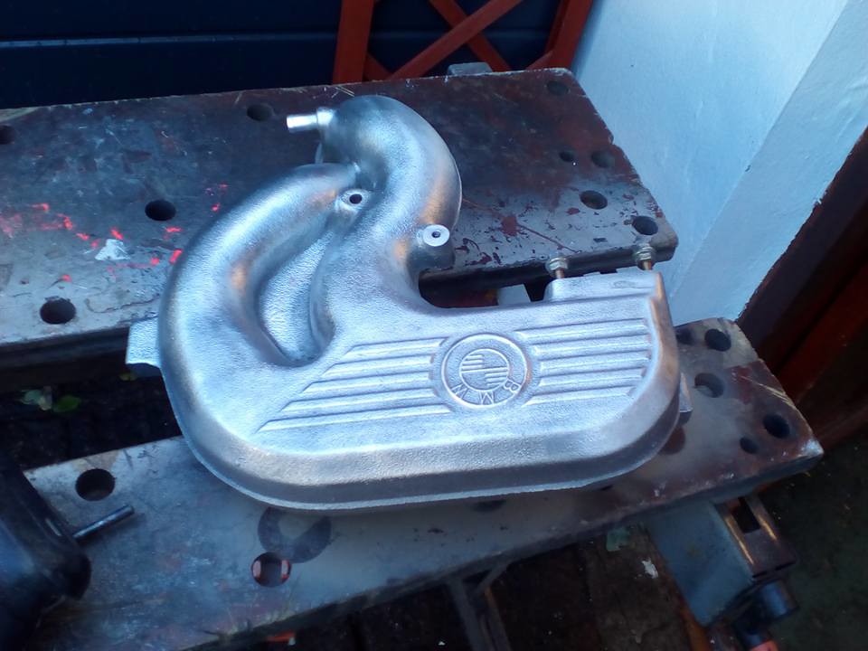

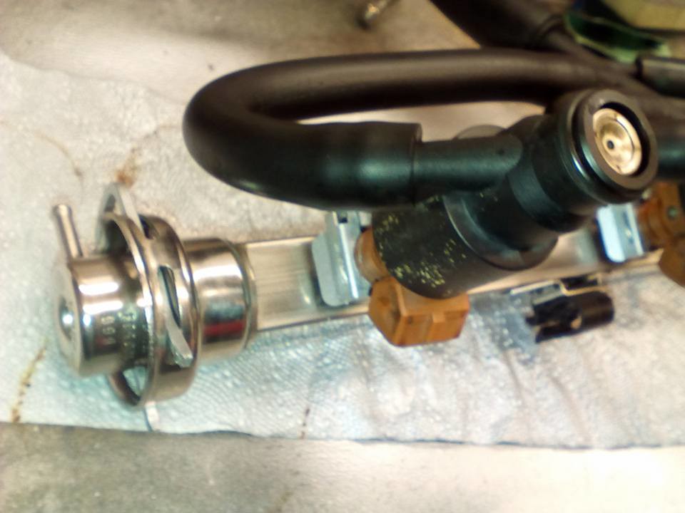

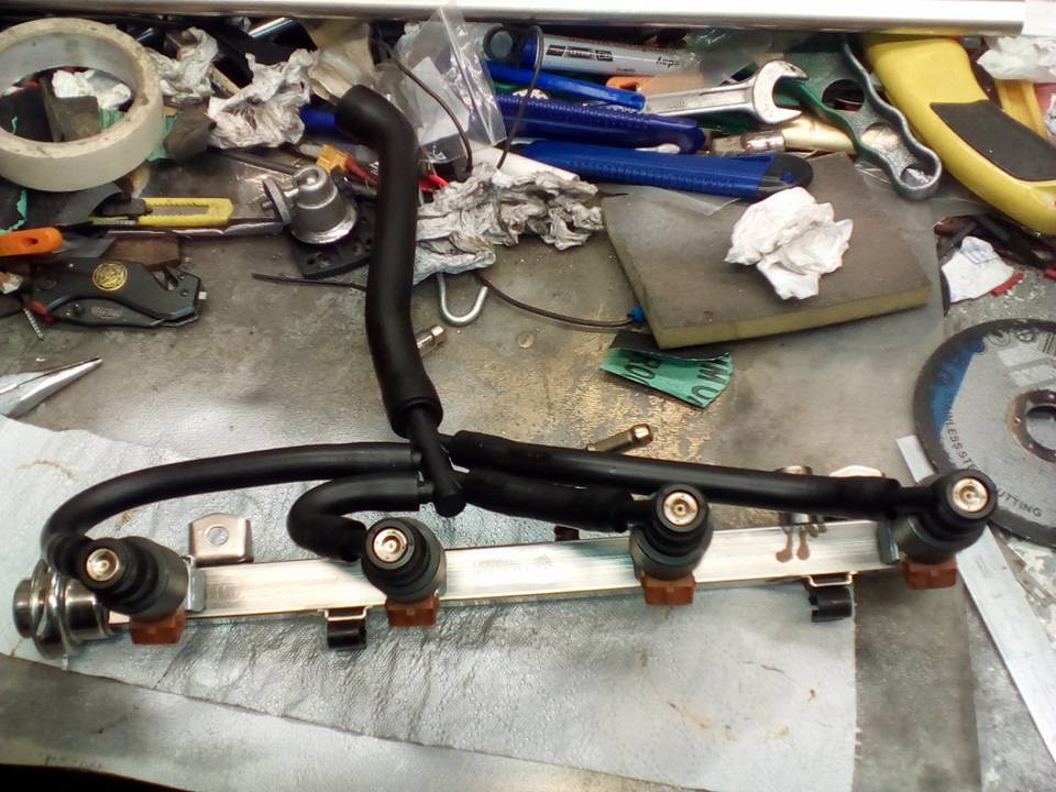

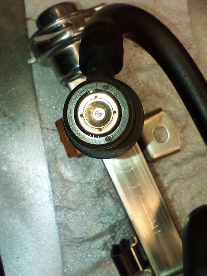

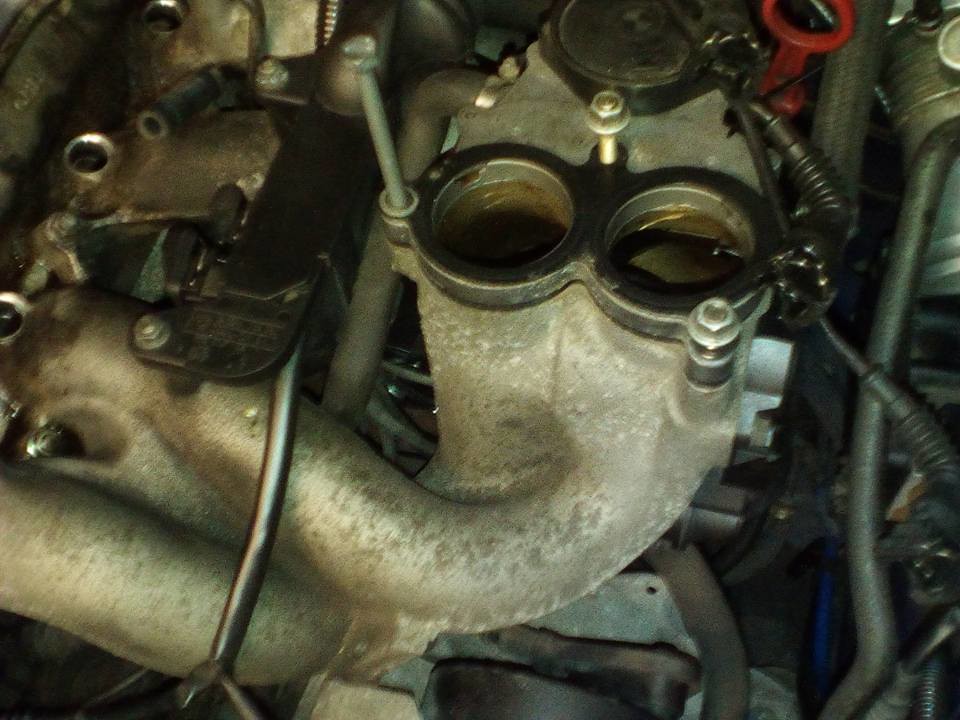

so had a quiet couple of days, and decided to strip off the top inlet manifold for a throrough cleanup... anyway while i was at it i pulled the fuel rail off and give the injectors are good clean too, my mate works in vehicle department in local college and had access to some great equipment... anyway he ultrasonic cleaned my injectors, purged with some magic cleaning fluid, and tested them on flow rig all were within spec and he said they were all pretty bad before the cleaning....

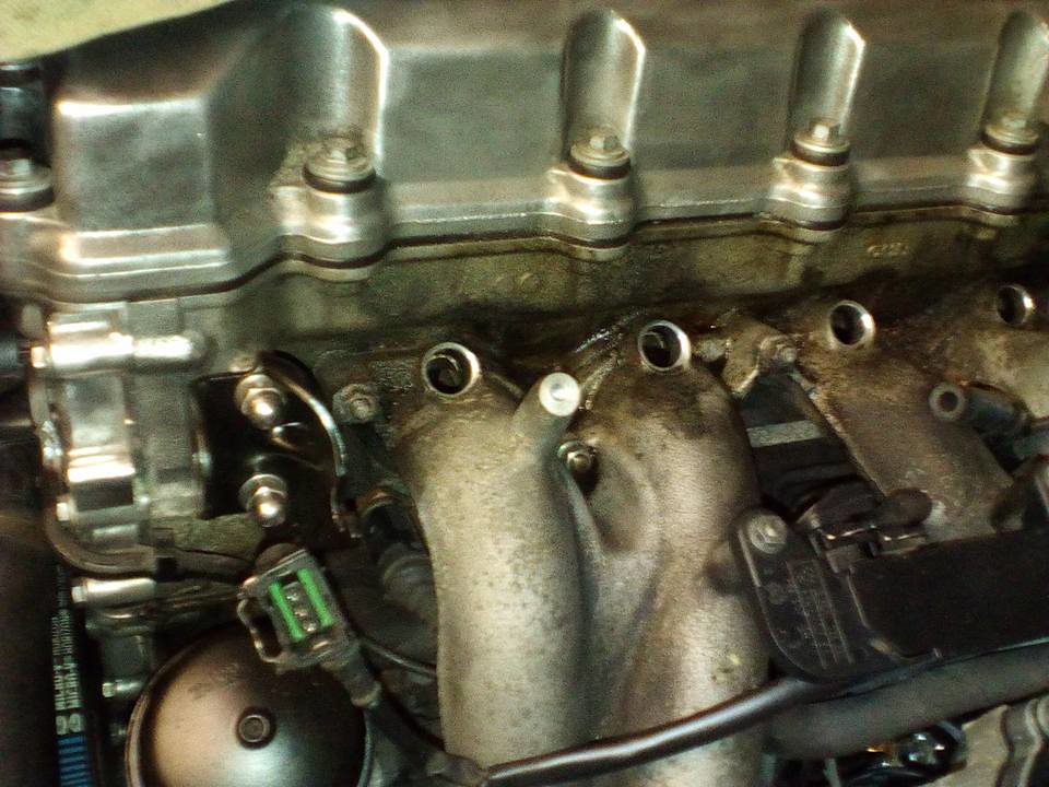

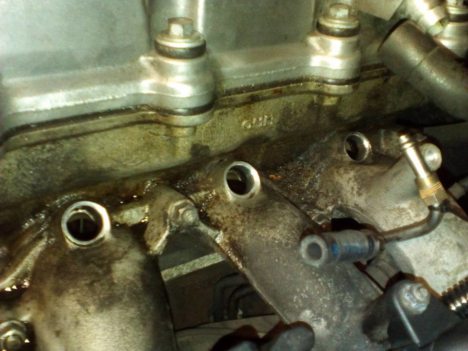

heres a few pics.. i going to put it back today have renewed a few clips and bolts as originally one of the inlet manifold bolts lower manifold were missing and a couple of jubilee clips were rounded off... someone had been here before and didnt even bother to renew a couple of cheap jubilee clips...
I am hoping once i get this put back i will have chance sometime to do the lower manifold to the same finish... it came out real good...
I wish i had take some pictures of the injectors before they were cleaned the difference is amazing..!!!!
