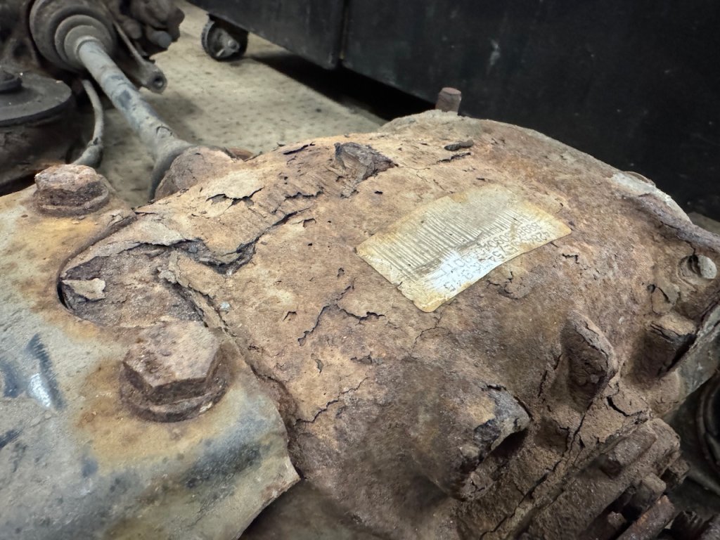

diff was looking very flakey to begin with
@Holliez4 went to town with the wire wheel and gave it a coat of hammerite
after coating, also expertly removed the old diff bush.

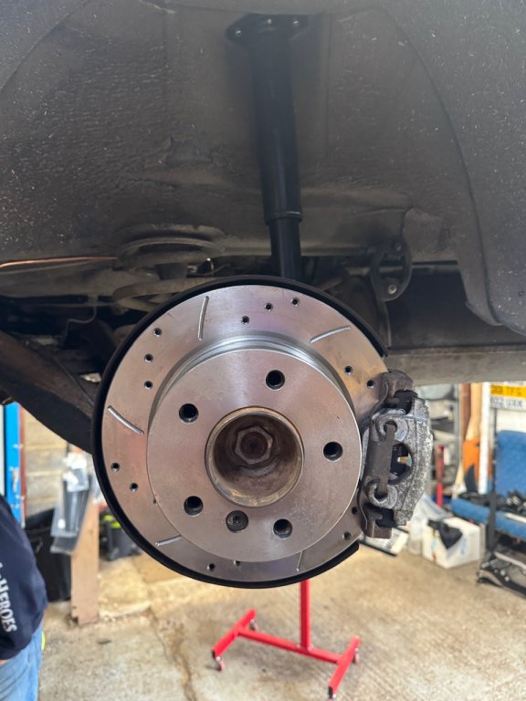

with the gearbox refitted we moved onto the rear. Took a few hours but she’s looking ready to refit now. Can now see the brake upgrade along with braided lines.
diff looking much better

First job was getting the new nearside wheel bearing on, the old one really didn’t want to spin freely.

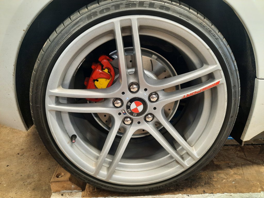

once that was on I could fit the two new calipers. Also gave those front Mtec discs a coat of lacquer as they normally rust up quick.
finally got the new handbrake cables in, so many company’s keep sending the narrow body 1.9 cables, here you can really see why they don’t fit.
shortly after both brake assembly’s were all fitted and ready for bleeding.
Nearside
test drive was brilliant, no more shaking when changing gear also front to back now feeling so much tighter. Along with a real positive brake pedal it really gives you a confident feel. I’m sure Kai will have a fun drive back.
