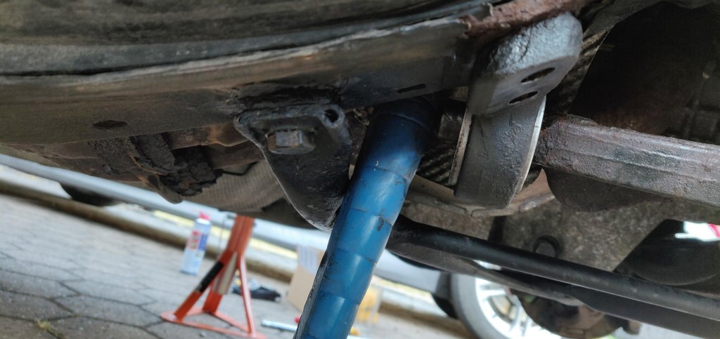

Lollipop Bushes.
I had noticed that the bushes in the lollipops were beginning to look rather tired and were worth a change. I also noticed that the ride was quite harsh and pot holes where very noticeable when driving.
![Pre start on lollipop.jpg Pre start on lollipop.jpg](https://zroadster.org/data/attachments/144/144345-e123c302469101ef445de8309bd5421e.jpg)
![Spraying WD40.JPG Spraying WD40.JPG](https://zroadster.org/data/attachments/144/144351-91fc3a28201ca5642f27db32bfde7b20.jpg)
I wasn't sure if there was any stored energy in the suspension system, so I was quite cautious in removing the bolts. These are 17mm bolts and using a breaker bar they came off hassle free. There is no stored energy in the suspension system when undertaking this activity. I had the car on axle stands to make sure there was no chance of movement.
