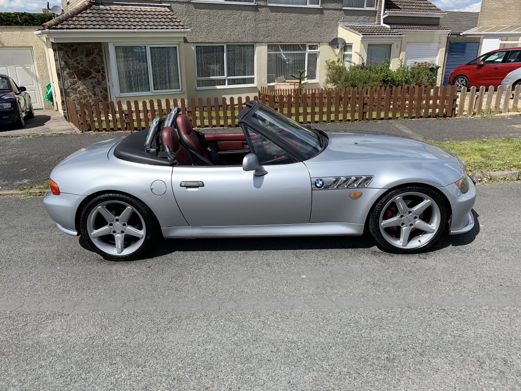

Looking to lower my 1998 1.9
Really need help on what will be best for the car. I want around 40mm ride height. Looking for all round balance between aesthetic and performance.
Looked at lowering springs, coilovers and lowering kits. On a budget of £300
Please can I have some advice on which is the best? Photo attached to give you guys a better idea of how far car needs to come aesthetically.
Thanks :)
