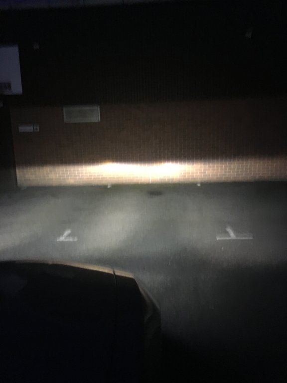

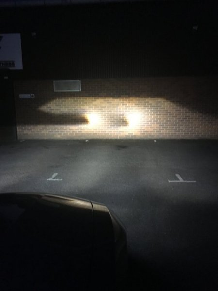

Hi Guys,
My main beam doesnt seem quite right on the passenger side of the car, on main beam there is a big dark patch through the light pattern on the passenger side and the light seems to hit the top of hedges rather than the road infront. The lights while on dipped are perfect...any ideas?

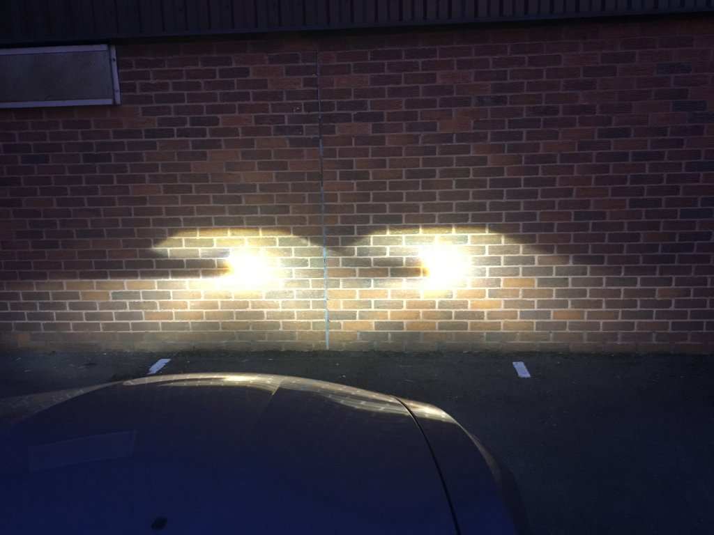

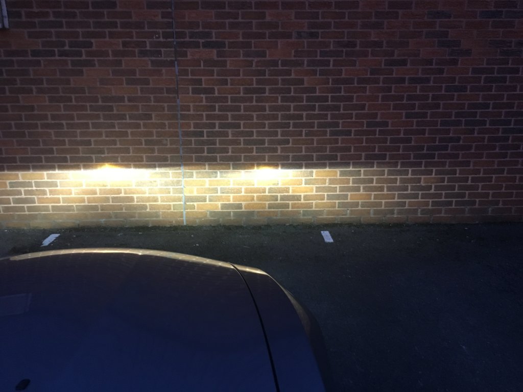

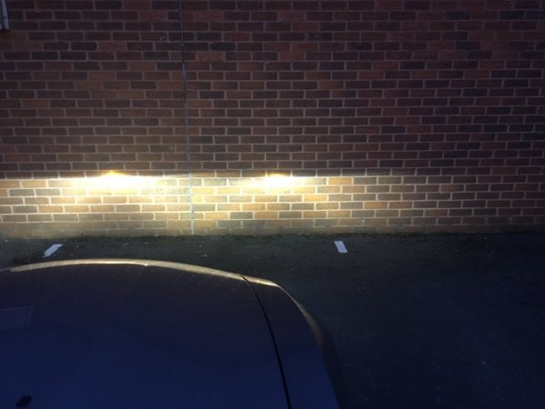

They look fine to me. We need another owner to take pictures to compare please. @billz , @Redline
Thank you Alex, I'm sure we're talking about an E85 Z4 as you can see the bonnet/wing shut line in the pictures not an E89. However I don't know if the headlights (and consequently their image patterns) are different or not.
