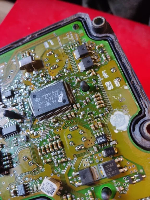

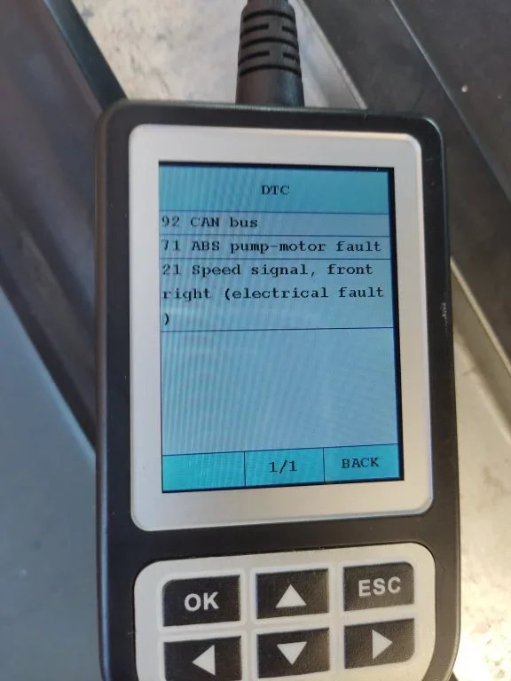

So my last MOT I just scrapped through on emissions so for this year I popped on a type approved 103 cat from B and M (not required on my 98 1.9) and new exhaust also changed the Disa valve. And PASSED emissions fine.
Then my ABS light came on, couldn't clear it so failed![Frowning face :frowning2: ☹](https://cdn.jsdelivr.net/gh/joypixels/emoji-assets@5.0/png/64/2639.png)

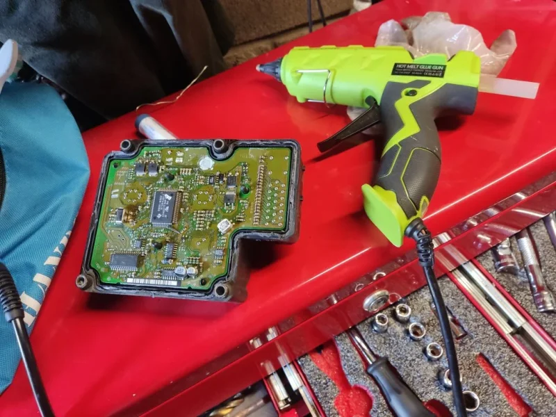

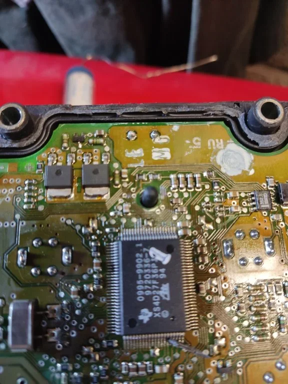

Opened up the ABS module , resoldered the pins and I cleared it. Hope it stays that way
If it does I'll get get a second test and should be a clean slate
