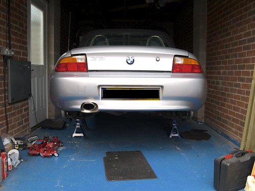

In order to get access the car needs to be quite high and both rear wheels need to be off the ground, there are a number of ways i guess, but for me i reversed it up on ramps and then jacked onto axle stands in order to remove the rear wheels. Now as the handbrake is on the rear wheels you will need to chock the front wheels to prevent movement, this was done with heavy rubber wedges. I used two sets of axle stands just to make sure.

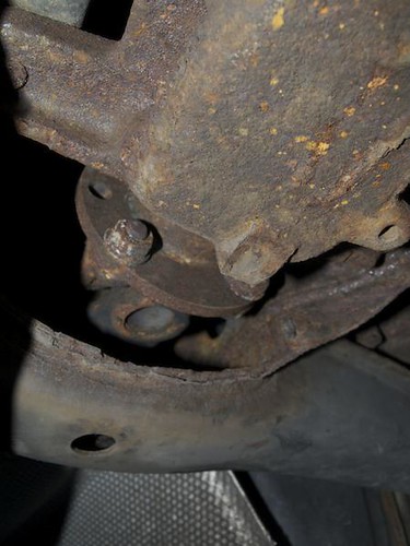

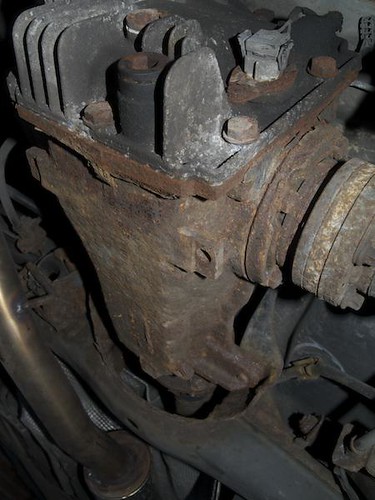

A few pictures to show the current state:
![](/proxy.php?image=http%3A%2F%2Ffarm8.staticflickr.com%2F7060%2F6871625108_e426a69084.jpg&hash=27cc2d68daa7aaa8c9179129c153ba10)
![](/proxy.php?image=http%3A%2F%2Ffarm8.staticflickr.com%2F7047%2F6871617718_7e4d54ae1b.jpg&hash=0d256e33421b2e8c34f9a5d149b36bae)
As you can see there is quite a lot of surface corrosion going on, the protective plastic cover on the rear axle carrier has been breached around the prop shaft and the Diff bush is separating from its carrier. The main concern though is the state of the fasteners, if left to continue they will not be able to be removed, so the aim here while doing general repairs will be to replace the fasteners and fixings.

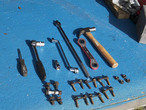

To recap the tools for removing the Differential are:
Trolley Jack, 16mm Spanner, 19mm Spanner, 19mm Socket Ratchet, E14 Socket, Breaker Bar, Hammer, Punch, Marker Pen, Lubrication (GT85)

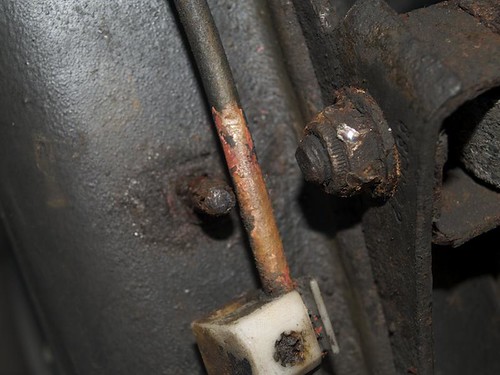

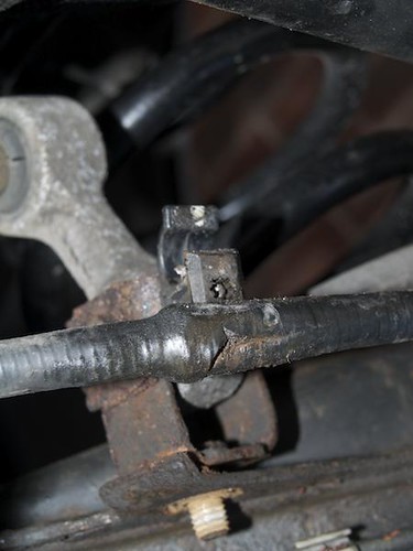

1) Start with the Lower Fixing Bracket by removing the nut 13mm A/F using a 13mm Socket, You will first need to remove the fir tree fixing (Flat Blade Screw Driver) holding the brake pipe as it obstructs the socket:
![](/proxy.php?image=http%3A%2F%2Ffarm8.staticflickr.com%2F7129%2F7017766179_ebac015048.jpg&hash=82994f67054632d67a829a10d9bdd221)
2) Remove the Hand Brake Cable from its clip:
![](/proxy.php?image=http%3A%2F%2Ffarm8.staticflickr.com%2F7050%2F6871660892_28f23f6b02.jpg&hash=713a3916b8d9fd0558f11c886b7d8456)

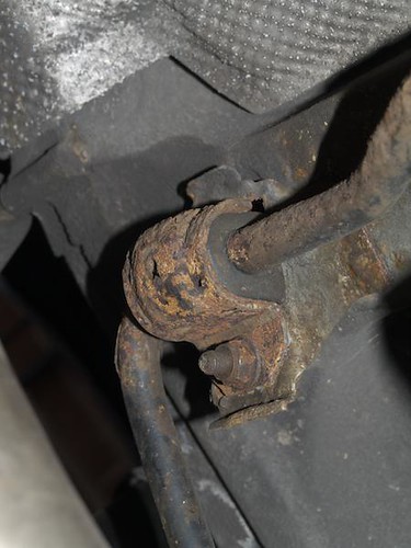

4) Next you will need to remove the nut 13mm A/F from the top retaining bracket:

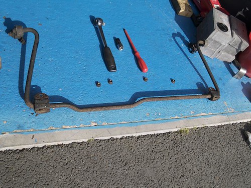

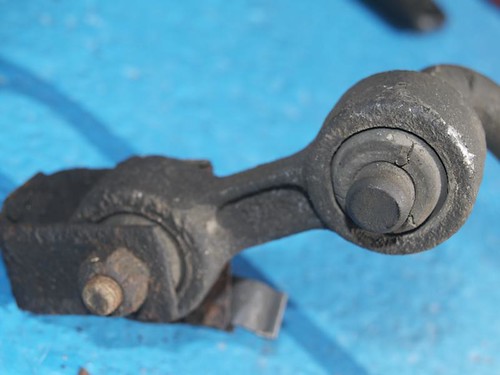

5) Repeat for the opposite side, you can now remove the Rear Anti Roll Bar complete with Drop Links, Note the worn bushes on the drop links:
![](/proxy.php?image=http%3A%2F%2Ffarm8.staticflickr.com%2F7210%2F6871671780_b5b5742e43.jpg&hash=32b9f79b1644cdf0bb2812baaacb9011)

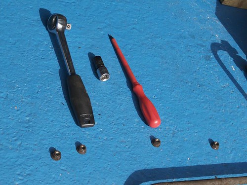

To recap the tools for removing the Rear Anti Roll Bar are:
13mm Socket and Ratchet, Flat Blade Screw Driver Lubrication (GT85):

Health & Safety First:
