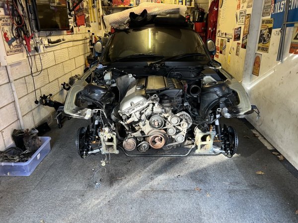

Nice big juicy update. We have success, it turns out this Z4 is in very good shape under all those rotten body panels. This rotten body panels took some serious time to remove mostly due to rusty bolts shearing or refusing to undo. We had a full team today, @mwpe @Mr C @GazHyde @Dom @Oldguysrule @mbrenan
First up is the front end, metal work is all in great shape no heavy corrosion or broken brackets. We gave the bulkhead a light wire brush and she came up well. The only damage up front is the offside (driver side ) headlight, it has 3 out of 4 tabs broken off from a deer strike this also split the bumper, that’s the first item on the order list.
First picture gives a good overview
this is passenger side looking into the engine. You can see a previous brake line repair this is common practice fixing them like this.
Front bulk head showing good signs of cleaning up.
shot focusing forward. The bracket sticking out is what the headlight bolts to and bumper aligns with.
Other side has light surface rust but again nothing serious.
so in all looking really good up front. The sills have some light surface rust. We see much worse on Z3’s. First up drivers side
Passenger side
Little bit of crispyness on the rear drivers side this wasthe worse bit
shot of the rear drivers side sill
Now looking at the rear this seems to be the focus of the corrosion. We currently have both rear wings ready to come off but we’re stumped on where the last bolt is inside the boot area under the roof if anyone can shed some light this would be handy.
An over view photo.
rusty crash beam, boot lid gingerly resting on the roof
we’ve been told Z4 rear bumpers are a moisture trap.
Up in the arch’s look good.
more showing the extent of the rust. Least we can see new springs and rear shocks recently. This leaves us having to source just front shocks n springs. We already have new brembo discs n pads all round and the callipers with carriers will be grit blasted
we will be changing this subframe out for the replacement. This is just nasty to look at.
funny large pile of body parts outside. We need to source 4 new wings maybe one sill. Still in two minds to either change the colour of car by changing most of the panels or paint a load of new panels ourselves, these decisions are being driven purely by cost.
we can gain a few pennies back from selling the old wheels. No curbing and 4 new budget tyres on, these will be good for someone send me a PM if interested. So the wheels will be changed for something more period correct and user friendly. Also the interior will be swapped out for a black set with heated seats. Baring in mind the car cost 1k, shipping £360, new brakes £200 so our max budget for everything can’t really go above £3.5k we’re guessing this to be the value of this Zed once finished, it’s going to be tight :D
