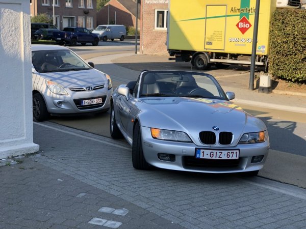

Hi ladies and gentlemen, I just noticed your forum and thought it would be great to connect with other Z3 owners. I have had my 2000 Z3 for 1 year now and absolutely love the car. It only has 77,000 kilometers on it and will be in the shop for the first major servicing. The problem with stallI get that I was reading about has just happened to me. I suppose it could be one of the things mentioned in the thread, but is it better this time to just take the car in for the service and tell them to check for the stalling issue while there?
