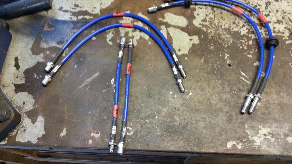

What's the rear hoses like to fit @t-tony I notice theirs 4 in total at the rear?
Yes there are 4 on the rear Paul. Original fitment is 2 short hoses with a steel pipe between them. The stainless hoses feature 1 longer and 1 shorter hoses which eliminates the steel pipe.
Only issue I had was that the hoses needed a large washer to stop the hose going through the brackets on the car. I contact the seller and they sell they would get this sorted so you may not have this problem anyway. But, if you do it just needs some flat washers drilling out. If you find you do I can post you 6.

The ones shown on their add shows 2 grommets on each pipe could these be for the brackets ILO washers?
Could be they push into the brackets and the hoses push into them? Wouldn’t be secure enough I don’t think though for MOT.
