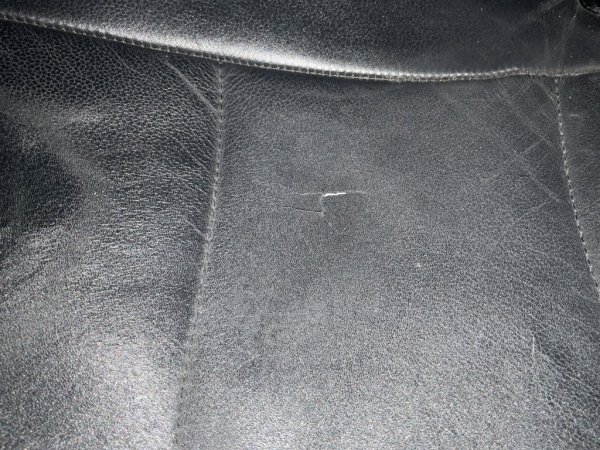

Who has replaced seat covers. What supplier, material, cost, reviews?
I was replacing my rear window and kneeling on the seat to work the zipper around and after I noticed a new tear in my seat.
2000 z3 2.3.
thanks for the experience.

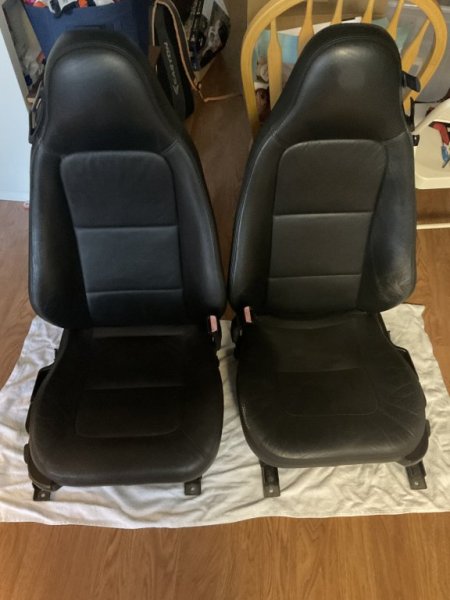

Thanks for the input. I am in the US, I updated my profile. There seem to be many option in three categories.
  1. Under $100 seat covers. Cheap covers
  2. $100-$200 questionable replacements of varying material
  3. advertised as OEM type quality replacement covers made of leather $400 and up.
i was looking for folks that tried these and the results.
i will be pulling the seats this week and will add pics
i have standard seats in black.

I was thinking that. I was not planning on touching the seats. I just bought this in November and plan to sell it in the spring or summer.

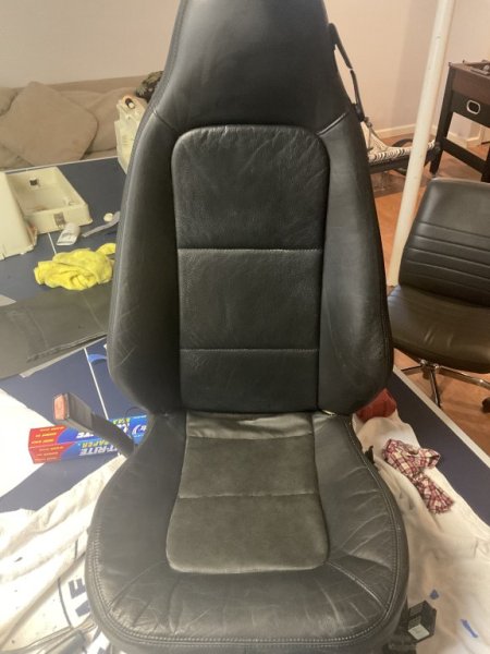

The panel that failed is crunchy. If only the two panels are crunchy I may try my hand at disassembling and replacing the panels.
I put them in the basement to warm up as it is frigid in the garage. I will soak the seats in some conditioner, try to recolor the small faded area, then decide to attempt to replace just the seat panels.
I would likely need to do both seats to match.

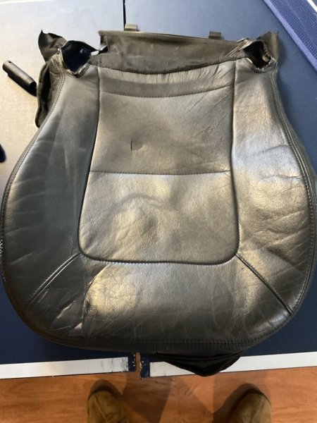

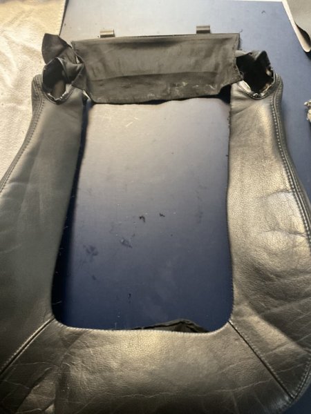

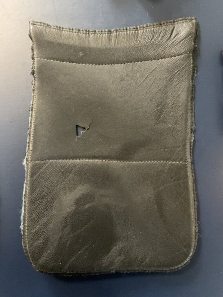

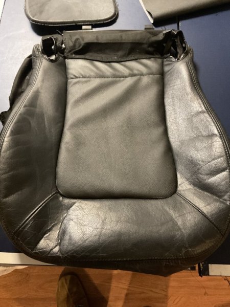

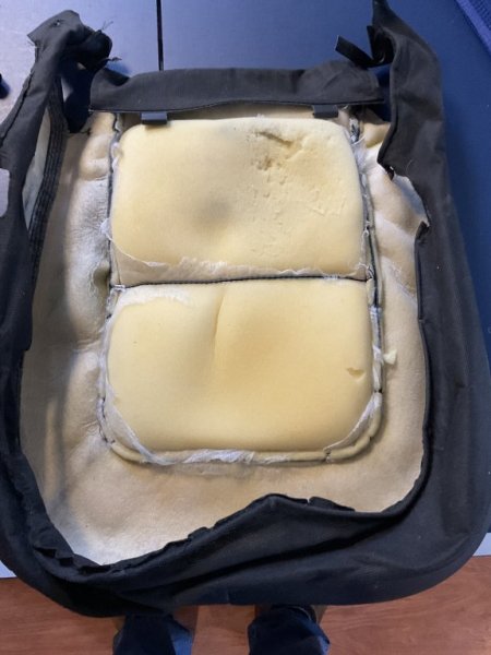

Removed the lower cover. Of the 5 panels that are on top, both middle ones are a little crunchy. The one with the new hole is the worst.
Even in the lower corner, the leather wants to crease. Maybe some leather conditioner will help.

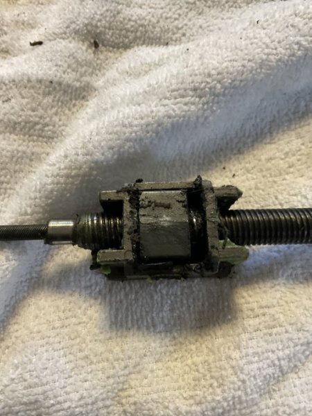

Also replacing seat bushing. First side was completely gone.
finished this part. Nice to complete a task.
Having put new leathers on these seats before, I wouldn’t think it’d be an easy task reinstalling the 25yo leather
Looking good. Well done.
