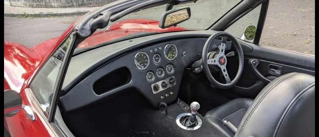

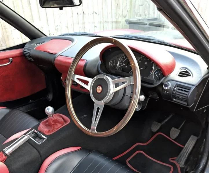

So it looks like 1st pic ie quite original and I am looking for something like 2nd pic. I like

The top piece of the second picture would need to be bespoke made as far as I know, as I don't know of anyone making flat topped dashes. There is a lot of work gone into that dash IMO.
My car has a moulded GRP dash, attached to a Z3 dash 'lip' under the windscreen. That was hard enough to get to fit and was made for the car.20250524_160714.webp20250701_124953.webp

The dash you are wanting is one of the best I have seen. Good choice.
The things that are hardest to reposition are the heater controls. It looks like the whole dashboard has been designed around their position - a very good piece of design, in my opinion.
It also looks like a very simple fabrication with one flat piece and one curved piece.
As said above, you need the windscreen vents, so you will need to butcher an original Z3 dashboard, but that's easy enough. The hard bit is getting all the curves correct, and those look pretty simple.
I'd start with cardboard, and work upto aluminium sheet, fibreglass and body filler. Aluminium sheet is an excellent material to work with as it is strong enough to hold shape, and is easy to manipulate. Fibreglass and body filler are excellent for making things look smooth.
