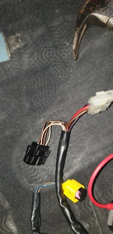

Hello everyone!
I made this post in the Facebook group and I got many replies however none were for the problem I had described. I think most had not read my post properly so I will try to describe as best as I can.
Both driver and passenger seats won't move up or down. Forwards or backwards with the side switch.
1. Both motors have been tested and powered directly from the battery and are fully operational.
2. 12v is supplied to the loom under neath the seat so power is not an issue
3. + and - 12v is supplied to directly where the motors are connected to the loom when the seat switched is pushed forward or backwards so the switch is not an issue and is functioning correctly
4. Fuses have been checked and are un broken.
5. Seat bushes replaced and the tracks have been cleaned and lubricated and are free moving when the spindles are driven directly by a hand drill.
But when the motor cables are reconnected to the loom under the seats, they do not move either forwards or backwards and show no signs of life when the switch is pressed.
Even when the drive spindles are disconnected from the seats the motors don't move.
Any one experienced anything like this or have I missed anything obvious?
Thanks alot

Hi Guys,
Thanks for the responses
It's a 1998 2.8 with standard seats.
I've since done a bit more fault finding.
I've removed both bases from the seats to make troubleshooting a bit easier.
I've found both seat bases now work correctly when connected to the passenger side loom.
But neither work when connected to the drivers side loom which narrows it down to that as the fault.
It changes what I thought before I couldn't get the passenger side to move either.
I've double checked all fuses both number 5 and 19 on the engine bay fuse box.
Are there any more that are unlisted that anyone knows about?
I recently had all the carpets and trim out due to water in the footwell so I'm wondering if that could be the problem? The fault developed just before I had taken the seats out to inspect and further found the water under the carpets.
Has anyone had experience replacing a wiring segment?

Does anyone know if I use the earth cable, from what I think is the heated seat module on the left, will that potentially solve the grounding issue or are they connected together.
Or simply a new grounded wire to that point.
I'm almost sure its the grounding on the drivers side as some of you have said thankyou!!
I'm getting +/-11.5 v in the passenger seat
and +/- 10.5 v in the drivers seat
Only difference is both seats work on the passenger side and neither work on the drivers side.
I've tried to tell from the electrical wiring diagram but I'm still not 100% sure
Thanks
