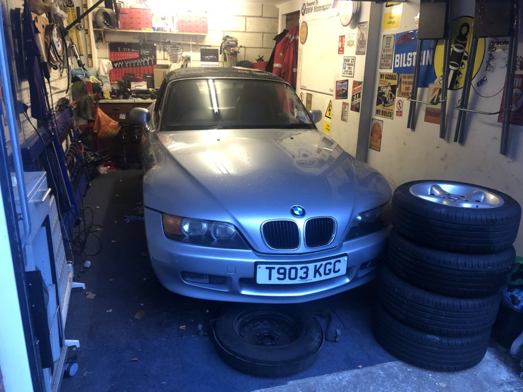

This is how we left her

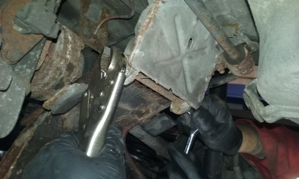

One of the first things off is the spare wheel carrier, which is where we started seeing rusty bits.

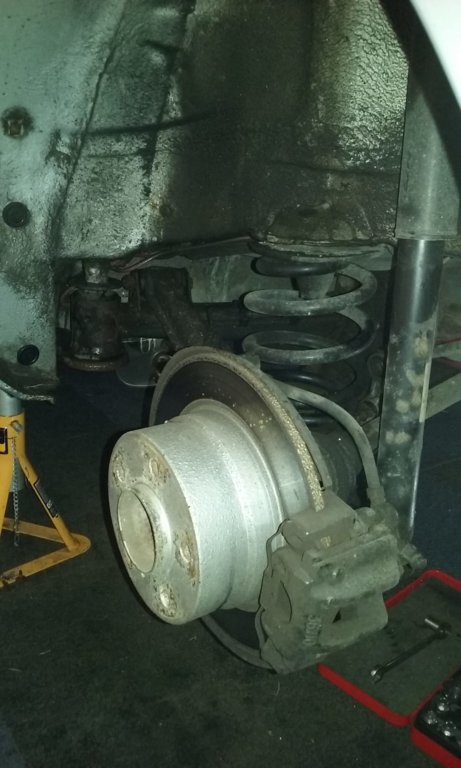

For a change this zed has had a the exhaust replaced so theres a joint half way down. This made the job an doddle to do. A couple of hours and subframes on the floor.

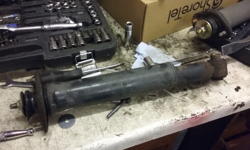

The shocks were toast, they never came back out to play again.

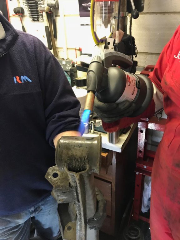

The normal warming of the subframe bushes to press them out.

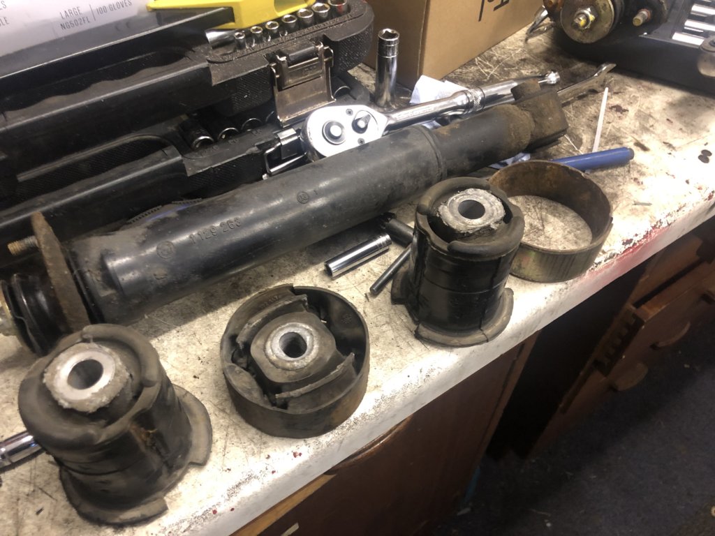

Collection of very soft and worn bushes.

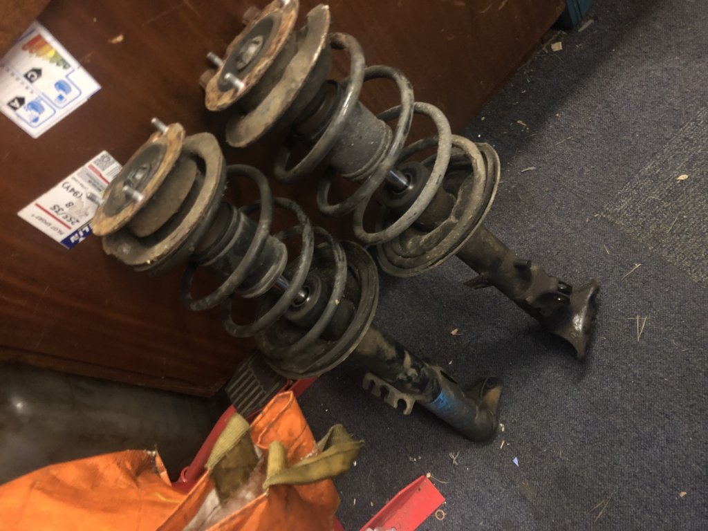

While we were at it we stripped off the front shocks ready for the arrival of the new shocks.
