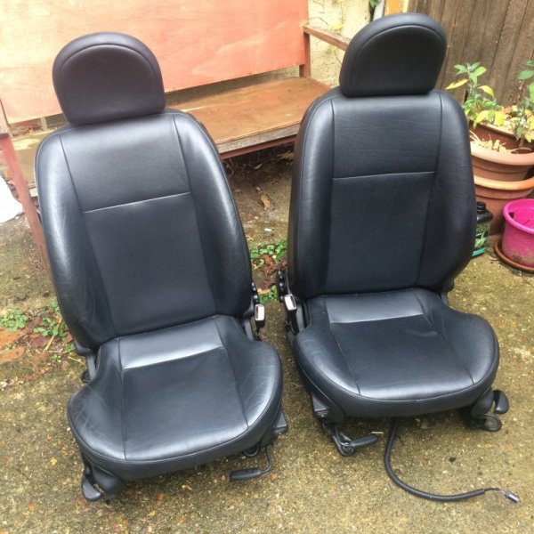

In a recent thread the subject of the comfort factor of std Z3 seats was discussed. Now I am about to embark on a journey to change a less than pristine 2.2 non-sport into a Cobra looky-likey so am not concerned with keeping stuff OEM . That means I can play a bit and feedback to anyone interested.
So on fleaBay i saw some black full leather seats out of a F@@@ Streetka mk2. They looked ingood nick so now own them. £100 including shipping. They are heated (well they have connectors and buttons at least) so I will measure them up and see how they go !
Current findings is that the seats are
54cm wide (across the bottom of the seat including bolsters and mechanism)
25cm from floor to front of seat
27cm from floor to sides of bolster
23cm height from floor to back of the bottom of the seat (where one's coccyx would be)
80cm total height incl headrest.
The fitting bolts are 34cm apart down Door side.
The fitting bolts are three on the tunnel side which are (front to back) 40cm and 52cm in distance.
Bolts are 41cm across the floor of the car.
Anyone have the Z3 equivalents ? Please.

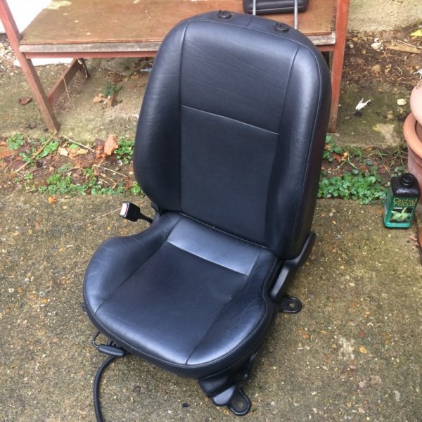

Here is a pic or two of said seats (without headrest in the last for those bad boys who want a sunny day with the wind in the back of their hair).
What I like about them is that their bolsters hold me better and they have tilt (rake) adjustment missing from the OEM models.
