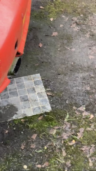

I have a 1999 UK BMW z3 1.8 - i think its m43b19 but not too sure, anyway, I think I have a head gasket issue because sometimes I have a lot of smoke coming from exhaust that I’d call sweet smelling however sometimes no smoke is visible at all (not sure what the issue is to be honest the car has been stood for 4+ years) and when I did an oil change after trying to revive it i over tightened the bolt and now it doesn’t tighten all the way, I don’t know what would be better - to swap the engine out and put a new one in or repair current issues - any advice appreciated:) any questions just ask I will try answer to best of my knowledge

Okay so with the head gasket are we definitely sure it is that? Maybe I should get an omd scanner and check that it’s definitely that so I don’t fix issues that don’t need fixing because it runs really well and the smoke is only occasional (but the last memories I have of it running before it sitting for 4+ years was it overheating. The smoke only being there sometimes might be due to my pathetic attempt at using head gasket sealer which I didn’t even use properly because I didn’t shake the bottle before hand - don’t let a 16 year old work on your car.) and if it is the head gasket which it sounds like it is can I just take the valve cover off and whatever is underneath plop the old one off and new one on and reassemble everything or would I have to have some special thing to resurface the block I don’t know anything about doing that

I can’t upload videos here? I could show you some videos of it running perfectly with no smoke whatsoever and a video of when it first started which shows the white smoke that I sometimes see which makes me think head gasket

White smoke is steam.
If the gasket is gone it’ll steam/smoke constantly, usually. If it’s only started occasionally you’ll have condensation in the exhaust, then it has to evaporate that off.
Do you have access to a compression tester gauge? That tells you if all the cylinders are firing equally. If not, get it warm, switch off and immediately pull the plugs, see if you have any steam coming out the plug holes.

Yeah, I am not a very good mechanic by any stretch, but white smoke like that (particularly sporadically) does look to me like condensation.I had a similar thing on my car after I bought it, but at the height of winter.
There's not a sign of any smoke coming out of the exhaust anymore (after a few running miles).
