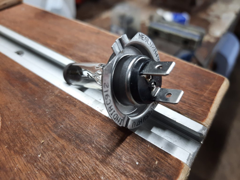

This is what an H7 bulb looks like Colin.
