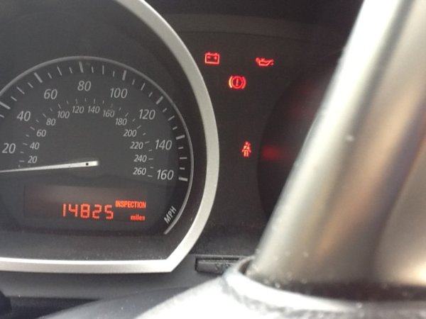

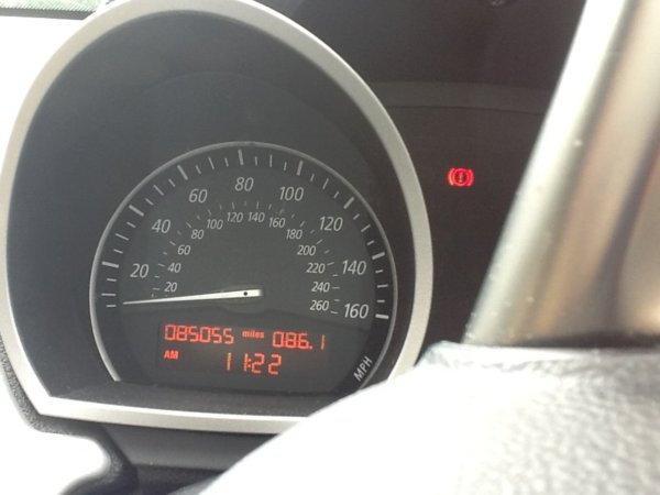

For example, I changed all my brake pipes/hoses for the steel braided type (makes a heck of difference!) and although I bled the system, I was getting warning lights on the dash. I plugged in the adapter, fired up the ipad and it gave me the code 005E21. This turned out to be the sensor for the front brake line on the master cylinder, I did do a re-bleed of the system but all was fine, so, before paying out £25 for another sensor, I removed the sensor, cleaned it, replaced it and no warning lights. I've have been told that someone else had a similar problem and did exactly the same but the lights came back on after a week or so. If that should happen then it's okay, I will replace the sensor, but I know what the problem is and am able to solve it.
