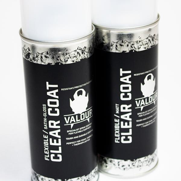

I tried simoniz chrome spray on one of my grill surround. It's VERY thin paint and I just couldn't get it on in a decent coat. I'll need to rub it off when it's dry but maybe I'll just rub it flat first and put on a coat of clear lacquer and see what happens. Can't make it any worse than it is. I'll report back.
Has anyone tried Rub n Buff with a clear lacquer ? I've used it on a cosplay and it looks good if you want "old chrome". Might be an expensive option though as comes in tiny tubes.
Krähental
Rub n buff. I'd never heard if it so went a googling.
Seems to be a wax based product. Maybe a bit like clear shoe polish with metalic particles.
Can't see something like acrylic lacquer working. Can't paint on wax.
DaveP
Mar 26, 2016
128
Reading
Z3 2.2 Kobra rebody (see pic)
You are probably correct. I covered mine (it was on a Jango Fett helmet made out of EVA foam) with a clear coat that was specific for covering acrylic paint and there were no ill effects.
the paint used was :
