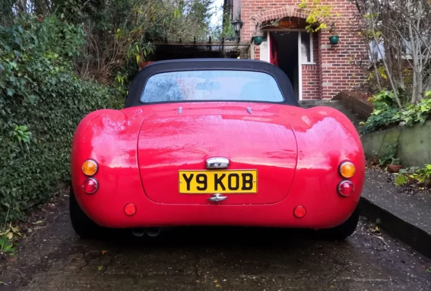

LOL, well after all that ... The front side light was a dodgy spade connector and the rear light was a problem with the Volvo lights not holding the bulb very well. Complete coincidence that they were on the same side and went at the same time ...
163
Pontrhydyrun - in Crow Valley
I posted a few months ago about those Volvo lights not holding the bulb. I had to squeeze my bulb holders with pliars to make the holder tighter.

Damn those light fittings ! I originally had land rover lights on my Kobra but they were cheap for a reason.
I failed an MOT because front indicator not working. Cheap connection! Nice tester gave me ten mins to find this out and fix it. Still annoyed at a Fail/Pass tho.
Then replaced those lights with metal lucas ones and been ok since.
