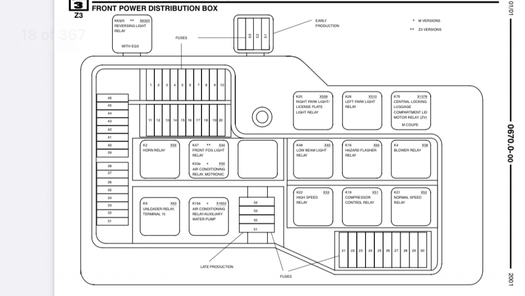

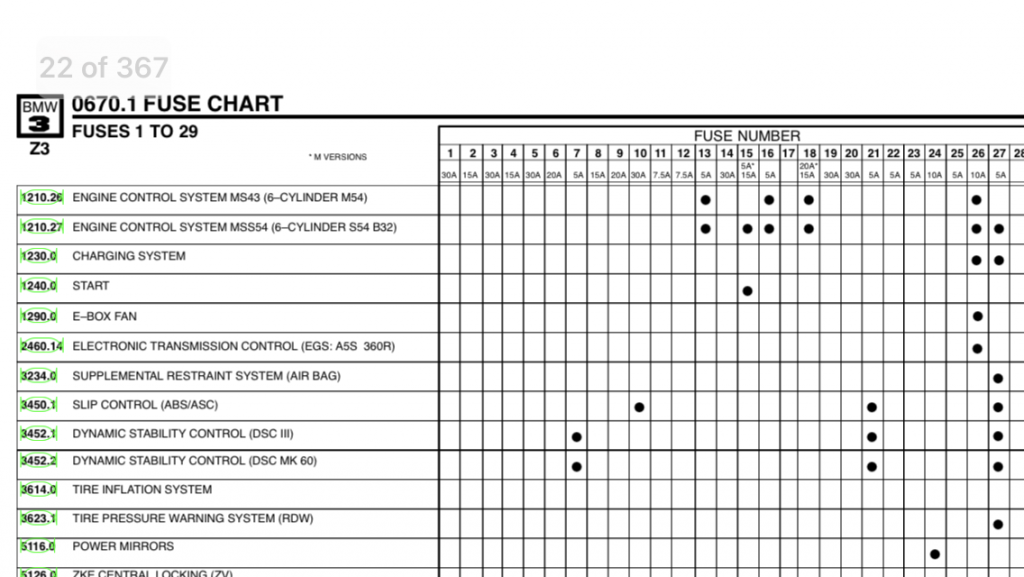

Did you get the wiring diagrams? This is where you needed them to see what fuses power the EGS.but I think I might be missing some (2001 z3 3.0i)
yes I got the diagrams,are these the right ones ? It says fuse 26 is the egs and it’s supposed to be a 10a, i double checked the fuse even replaced it with a brand new fuse. Still no change. What’s next?Did you get the wiring diagrams? This is where you needed them to see what fuses power the EGS.
