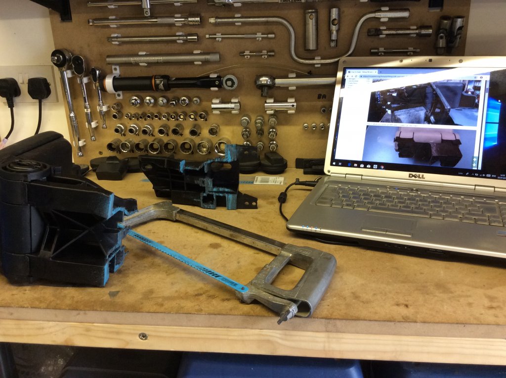

I used air tools once I was at the stage you are now, mainly an angle grinder and belt saw, just kept trimming and test fitting in my spare consoleWell made a start.....its a lot harder than I imagined, as the plastic is hard and difficult to hold, but have got some of it removed.
Of course, I was only joking about printing off Seans pictures.....
..........it was easier to have them on the laptop right in front of me ( hope I’m not infringing any copyrights???)

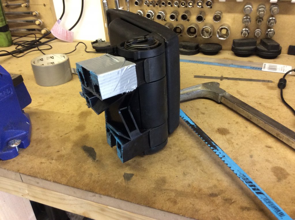

First lump off..

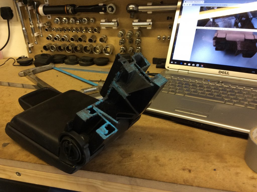

Cut down the handbrake side, but left about 10-15 mm to trim down.
Used some gaffer tape to try to keep it straight on the bit that sits in the tray.
So far so good....but thats it for today. No point rushing it.
From this point, I might start filing it rather than sawing it. ( and get the vernier out to check all the dimensions !)
the cutting discs will melt it pal, get some 36 grit discs to grind it awayThat's an idea, I have a small angle grinder and loads of 1mm cutting discs. Thankyou
They whip it down really quicklyThanks for the advice Sean,
Just picked up a Backing Pad, and a pack of 10 off, 36 grit fibre sanding discs, Less than £6 for both, from Toolstation.![]()
