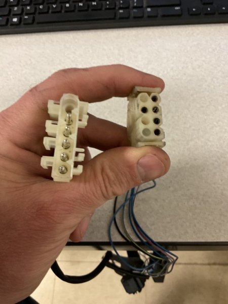

Hi all, am going through a cruise install myself. Just bought a 99 z3 build date 11-98. Found a great thread in here with great pictures and info, so ordered the part numbers listed off eBay. But some steps I’m unsure about-do switch and module plug into each other, because mine are different connectors (picture attached of both.) Found the small connector to plug into module fine but can’t find the throttle actuator assembly that he attaches module to-mine doesn’t match pictures in the walk thru. His was listed as an 02 3.0 so didn’t know if that was all drive by wire or had the cable from pedal to actuator. I’m very new to BMW, just bought the car 3 weeks ago and am a little lost on terms and systems and models. Link to info I have been following is https://zroadster.org/articles/bmw-z3-m54-cruise-control-retrofit.25/ . I think I’m just missing a step somewhere, but don’t know where. Would really appreciate any help you can give a noob.
tater82801
Apr 22, 2022
3
Starting to think switch my be incorrect. Can see how module connector goes into stack on column, so that’s something…

You do not say which engine you have, I wouldn't have thought that an 11-98 car would have the M54 engine. That article is forr the fly by wire throttle as fitted to later cars, the earlier ones need a mechanical cruise control.

If you have a pre facelift car then chances are you have the correct stalk but the wrong interface. (Based on your pictures.) On the early cars it's not just plug and play. The retrofit is a bit more involved.
I have a 2001 3l Z3. I had the same bits as you and the same issue. However, I had the correct interface and the wrong stalk. I had to get a new stalk.
In conclusion, I think the retrofit guide you are looking at is probably not the one you want.
Hope this helps.
