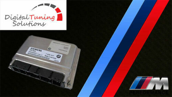

Get it re-mapped or buy an ECU with these altearions built in. I used an off-the-shelf ECU and it has been flawless:
Make sure you tick the correct boxes for the various upgrades.
P.S. Keep the old ECU until you are sure all works well then send to them for a refund (£25 from memory).

This is who I used for mine. If you have cruise control it might work differently (mine does). I now need to move the stalk up or down to activate it before I can set the speed, moving the stalk up or down again de-activates it. Also I put a bulb in the instrument cluster and have a working cruse control light. I think the base settings are from a 3 Series E36 but that is only opinion, I don’t know for sure. I do like the way it works now and having the working light is unusual in a Z3.
