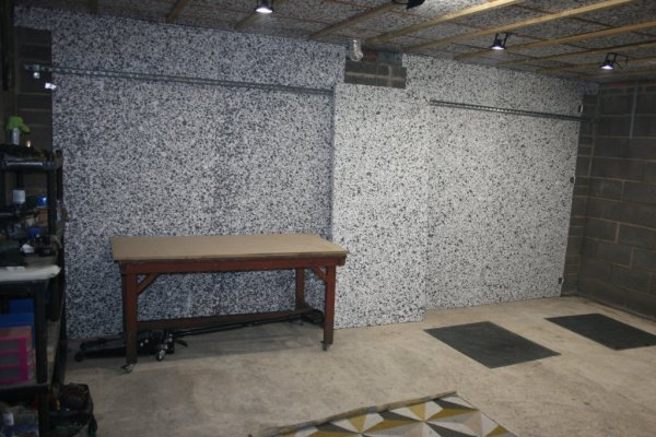

First things first....my 'garage build'.

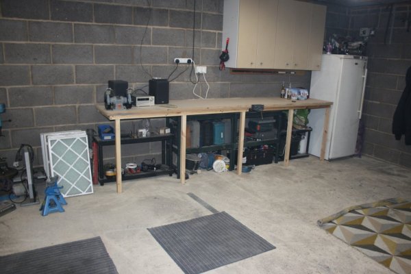

I have spent the last few days making my garage 'fit for purpose' as it was a complete mess with too much junk and not enough space. First thing was to sell the car that was taking up half of it. That has gone. I made a workbench at one end with some MDF I had lying around and some PAR timber (which I had to buy).

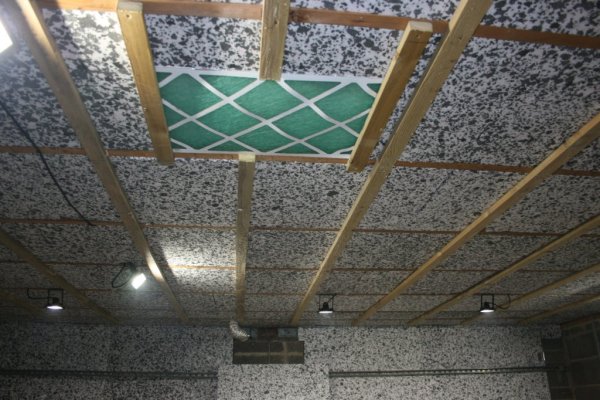

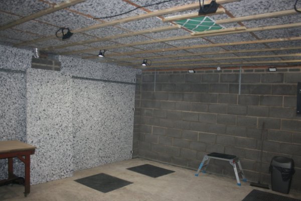

I then bought some 50mm Jablite polystyrene boards and insulated both up and over doors and between the ceiling trusses. 2" x 1" roof batten is there to stop any insulation from falling down!
I installed a filtered centrifugal duct fan to extract any dusty, or smelly work. I had all the materials except the fan which was very cheap. It will change the air in the space around 3 times an hour, which is more than sufficient. It extracts behind the jablite on one door as there is loads of air gap around the metal door. The door sized piece of insulation fits into the frame of the pedestrian door so I can keep it warmer when the weather is really cold. I will be getting a small electric workshop heater next week.

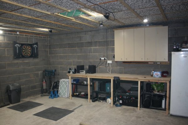

Couple of comments. 1, close the dartboard doors (you won't have time for that;)). 2, put a shelf up on the wall for your Hi-Fi (free up more very valuable work surface on your bench) and 3, That bench on wheels will pay for itself many times over!
Enjoy!
Enjoy!
The dartboard needs to be there for when I need to throw things. I have a feeling it will be often!
The bench on wheels was a garden bench that was left by the previous owner of the house (4 years ago). It has been quite useful as an outdoor bench so I didn't have the heart to break it up. I had the castors lying around and a bit of left over MDF, so here we are!

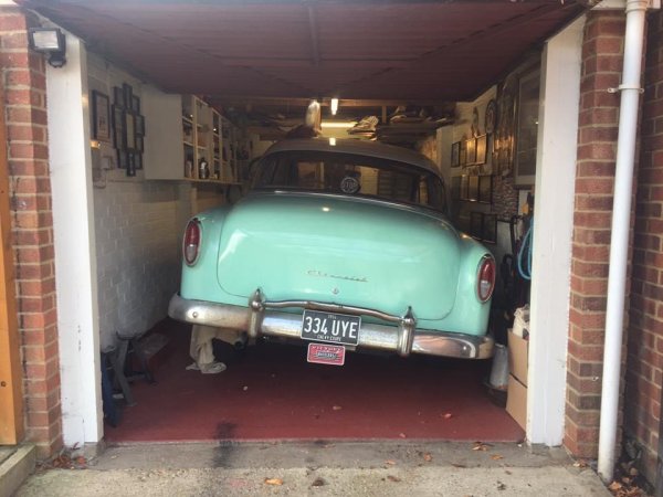

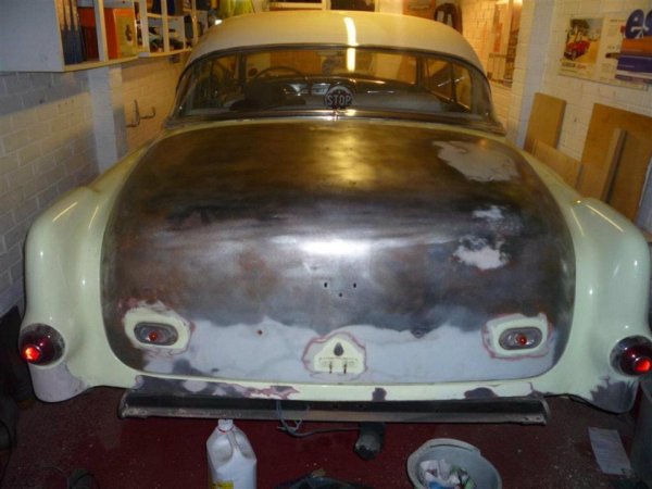

It gets fun welding a floor and sills on a 54 Chevy and bare metal stripping a 53 Pontiac. Only one side access at any one time and Pontiac was touching wall at far end, being 18’6” long.
The zed is a breeze in comparison 😁

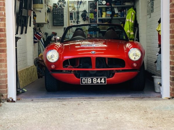

Yup. Single is all I have. Just 3m wide. It's quite high so just added a mezzanine floor to put lots of stuff out of the way so that I can actually open the doors a bit. Also makes the ceiling lower so hopefully warms up a bit come winter. Got some lighting in there but not enough. Planning on getting a lift but can't decide which. Don't plan on working under the car much but just lifting to make it more comfortable working along side the car without bending over all the time.

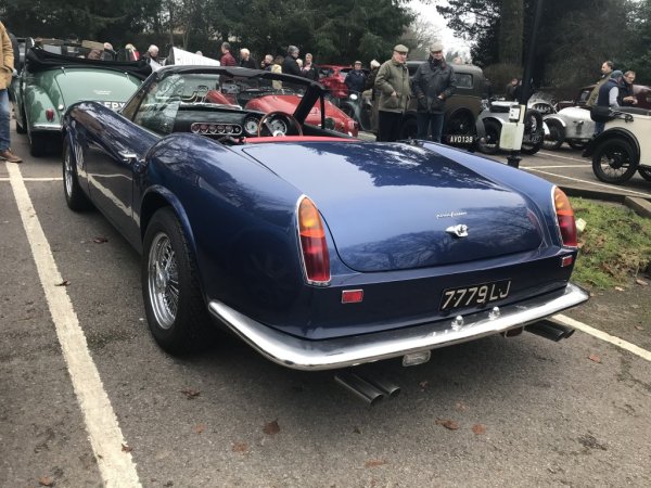

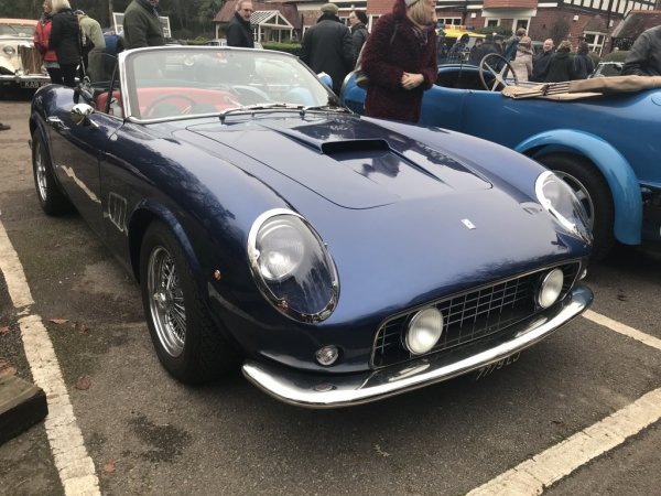

Some more reference material for you. This was at Goodwood breakfast club in June.
Pond
Dec 26, 2016
144
Spaldingski, Lincs
Z3 project and E89 Z4
View attachment 281367View attachment 281369View attachment 281371View attachment 281373
I recognise the reg on that one from back in 2016. I think that was one of the first DNA ones to be completed and sold via auction.
It maybe the DNA 'show car' TBH. Car porn, that what it is. God I love the 250 cali swb shape! o_O
