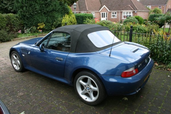

So got the donor car. After a day and a half going through it, it does seem a really good one. No rust anywhere. A good service history too. Obviously been garaged all it's life. I will be getting a new roof at some stage, but the mechanicals look really solid. Going to get the Vanos serviced, oil changed and brake fluid changed then we are ready to get cracking!

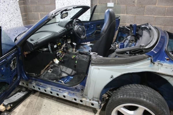

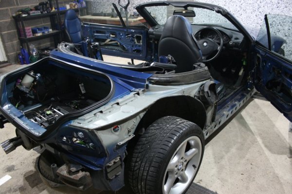

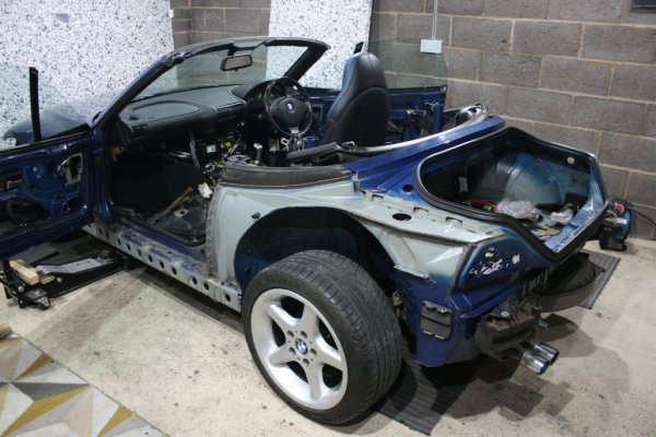

First update:
Body panels almost stripped. Interior half stripped (and wiring labelled).
There have been a few hurdles so far, which are not all rectified yet. Water has been getting in to the interior (A pillars), so the carpet foams are all sodden (and I mean sodden). This has fried the two DSC sensors on the pax floor (even though it passed an MOT with no advisories a few days before I got it :mad:. Someone got a dodgy MOT done, as, aswell as the DSC the front discs are below minimum thickness and there is a big chunk out of one of the tyres).
It looks like the big seal on the windscreen/ roof is blocked all down the A pillar, so may need a new seal. There has been water getting into the boot from the aerial grommet as this was split. Sorted and I won't need the external aerial but it has rusted the main aerial bracket so there is no radio reception. I can sort this easily, though.
The car had been stored previously for quite a while, so it has become resident to many, many families of mice. I have got three bin bags' full of leaves, compost and cob nut husks from various places throughout the car. The inner sills were both full of leaves and woodland produce. even the alternator vent duct was clogged with leaves! Luckily the rodents haven't chewed through any wiring, or anything required to be kept.
Vanos has now been rebuilt, along with brake fluid, oil change, new filters and plugs. The engine purrs like a kitten now.
On the plus side there is no rot or corrosion anywhere, the body, tub and chassis are in exceptional condition for a near 23 year old car. Just about to take the plunge with the expensive bits, so wish me luck!
