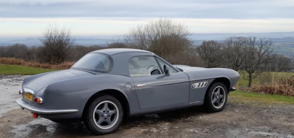

My kit arrived in November 2023. For the first month I didn't touch the kit. Concentrated on the mucky underneath stuff since then. Rear beam bushes. New brake disks. Hand brake cable. Bit of welding and whatever else I fancied doing while under there.
During the holidays I turned my attention to the body. First thing I wanted to fix was the left hand headlight surround. Other Tribute 507 builders have mentioned it. There's a glitch in the mould and the left hand headlight mounting surface is bent.
I decided to do all of my fixin in the lower half of the surround where, I reckon, the bulk of the problem is.
First I cut a crescent around the whole lower half to allow the headlight bowl to be fitted which pulled the surround/ring vertical. Then cut strips in the panel below the light and pushed the strips up and back to meet the surround in it's new position.
You can see by the size of the cut how big the problem is. It's not just a mm that needed sanding off.
Bonded it all into place with fibre glass behind.
I need to do work below to fit the indicators so preferred doing the work to rectify the headlight below the light so not messing with the top at all
Indicators next.

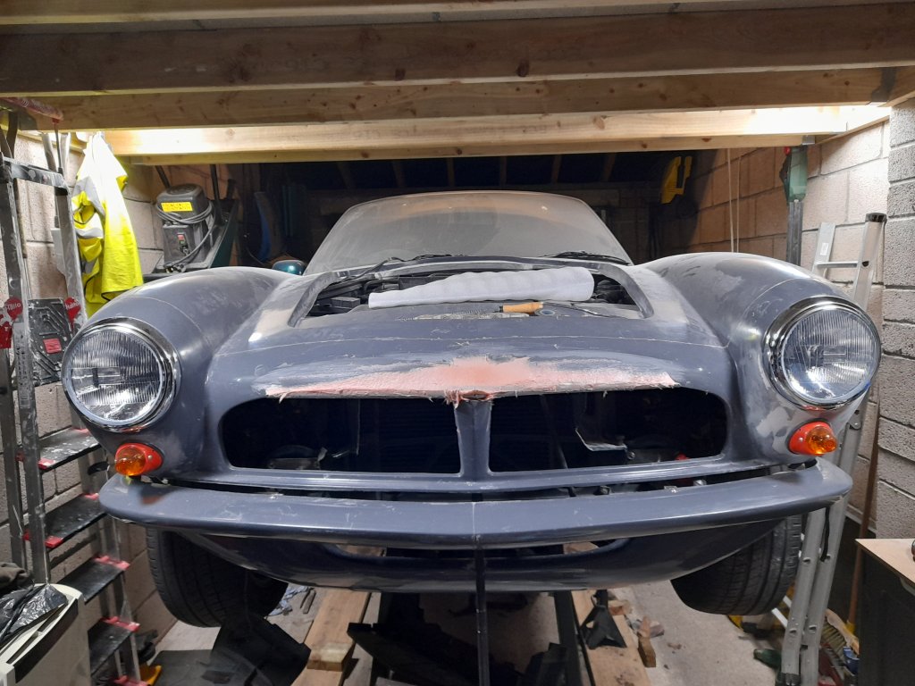

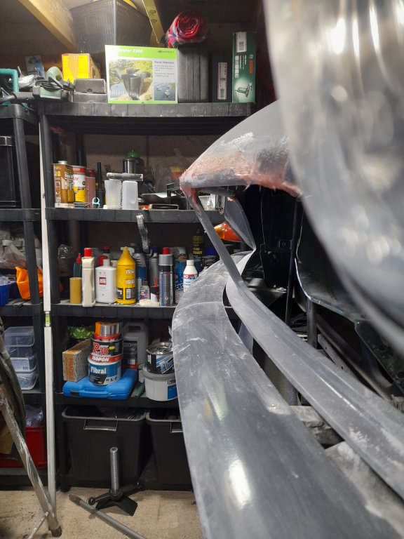

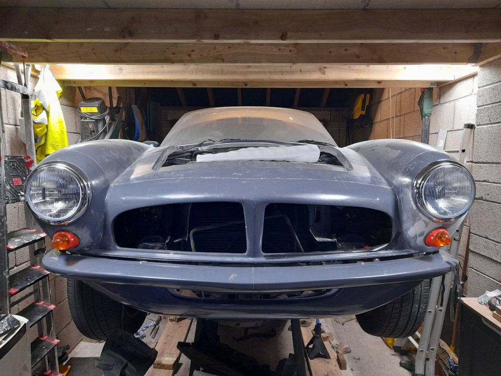

Next on my list is that grill shape. I never liked tribute's take on the 507 grill.
Much too tall.
Puts me in mind of an Aleggro VandenPlas.
Over the holidays I'll chop the front off rebuild it. I can always buy a new one if I screw it up.
Subtle, but very nice.

The blending looks very good from the pictures.
Just one question....it looks like the bumpers are GRP. If so, how do you finish them?
Krähental
Thats some gloss grey I put on there to check the shape of fhe nose extension. The refection of the over head lights will show up any problems with the shape. It's not perfect but good enough for now till I go to paint.
Yes. The bumpers are GRP. I haven't got that far. I might do everything in body color with minimal chrome. So bumpers and mirrors etc in body color. If I get tired of the body color I'll have them wrapped in chrome vinyl.

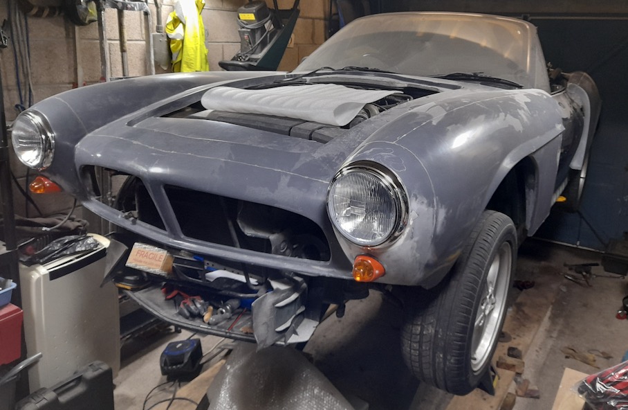

Looking great. I like the nose extension....looks almost shark like. I hadn't thought about doing that.
I'm fettling with the grill surround at the moment. I bonded clips to the fibreglass surrounds and have bonded timber blocks that I will fibreglass on the clamshell. The surround can then be screwed the timber block to secure it. I should also be able to fix the mesh grill to it.
Krähental
Wood? I used wood while I was fixing the LH headlight surround but in such a way that I could take it back out again once the FG had gone off. For my nose job I've got alu tube in there and will put some along the bottom of the grill as well and screw the grill insert to the alu tube.
I've had to cut my grill insert down a bit because my opening is now a little smaller.
