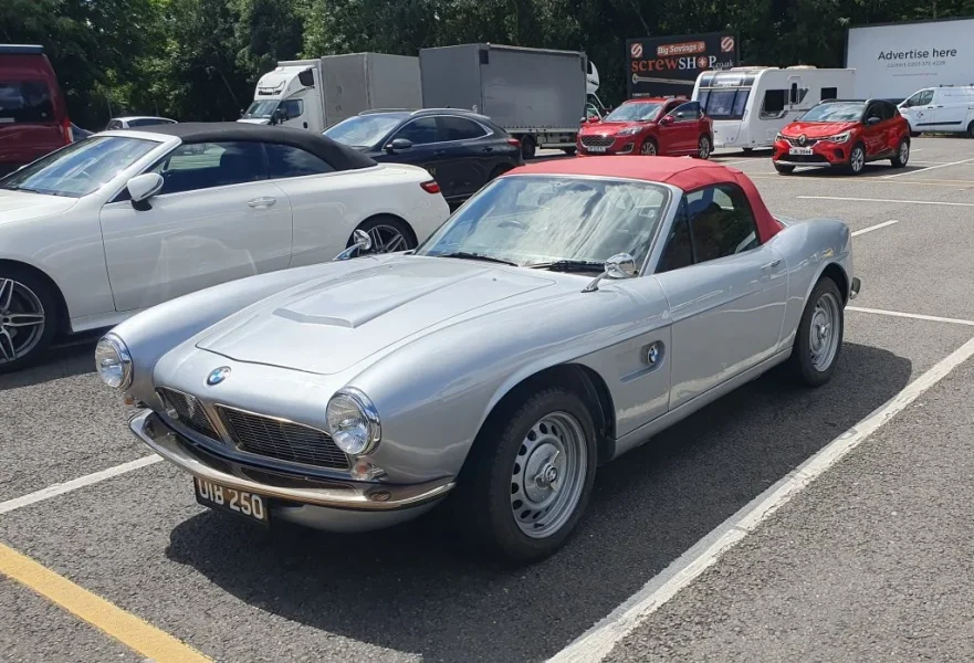

Opinions about wheels please.
First thing to remember - I'm not trying to make a replica 507 so I don't mind doing things different. Like the original Z3 door mirrors. I just feel more comfortable with modern-ish mirrors and not tiny chrome ones stuck way down on the bonnet.
I know others have gone for 507-style steel wheels with faux spinners. I don't think I'll ever bother with the spinners. But I do like the older style wheels with the 'pepper pot' look.
So. What about this guys?
I suppose I could paint the wheel middles body colour then they'd look not much different to the steelies others have used. But I kinda like the 'alloy' wheel look. What'dya reckon?
By the way - that's just a photoshop chop job. Wheels aren't really there. I'm just deciding whether to pull the trigger on a set. They're not too expensive either.

Agreed alloy Pepper pots aren't expensive, I think they are a good option and don't look out of place. Is that your final body colour ?
Pontrhydyrun - in Crow Valley
Currently that's the gelcote colour. RAL7015
I haven't decided on the final colour. Maybe close to the gelcoat colour or something like Mercedes Blaugrau. Here's a merc roadster in it.
I'd look for a bmw varient of that
