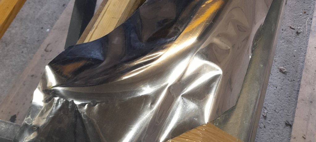

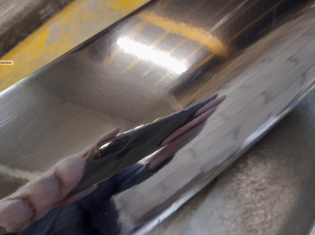

Having a go at wrapping - but as per usual I just go straight in without reading up on how to do it 🤷‍♂️
Turns out there's a thin plastic film over the surface of the sheet that protects the gloss surface during transport/packing. You're supposed to peal it off before trying to use the vinyl otherwise it won't stretch properly. Suffice to say I didn't peal it off. d'oh!
Anyway. The chromy-glossy-ness is good.
Excuse the mucky hand marks
Can't see it in the picture but there's creases all the way along the bottom of the bumper so I can't leave it like that.
(a) Need more practise.
(b) Need to remember to peal off the protective cover
(c) Need more vinyl because I used it all up in the first attempt.
But I think it'll look OK eventually

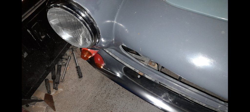

My kit arrived in November 2023. For the first month I didn't touch the kit. Concentrated on the mucky underneath stuff since then. Rear beam bushes. New brake disks. Hand brake cable. Bit of welding and whatever else I fancied doing while under there.
During the holidays I turned my attention to the body. First thing I wanted to fix was the left hand headlight surround. Other Tribute 507 builders have mentioned it. There's a glitch in the mould and the left hand headlight mounting surface is bent.
I decided to do all of my fixin in the lower half of the surround where, I reckon, the bulk of the problem is.
First I cut a crescent around the whole lower half to allow the headlight bowl to be fitted which pulled the surround/ring vertical. Then cut strips in the panel below the light and pushed the strips up and back to meet the surround in it's new position.
You can see by the size of the cut how big the problem is. It's not just a mm that needed sanding off.
Bonded it all into place with fibre glass behind.
I need to do work below to fit the indicators so preferred doing the work to rectify the headlight below the light so not messing with the top at all
Indicators next.
