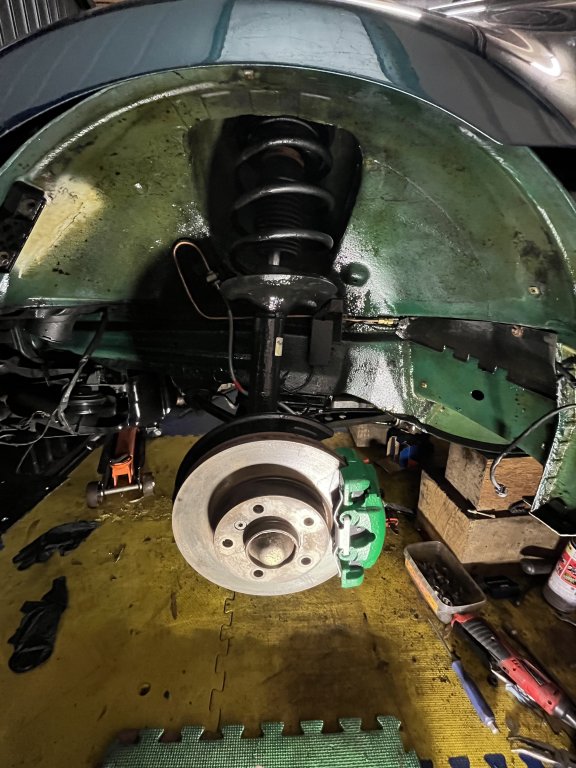

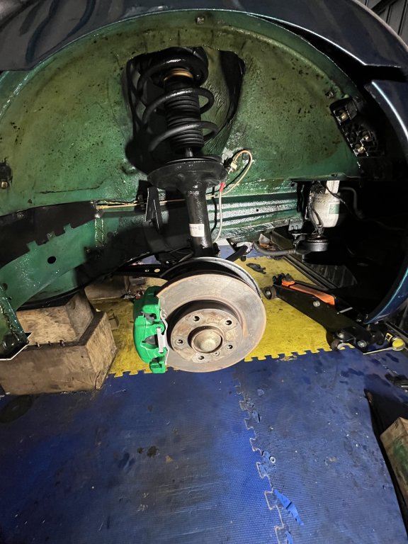

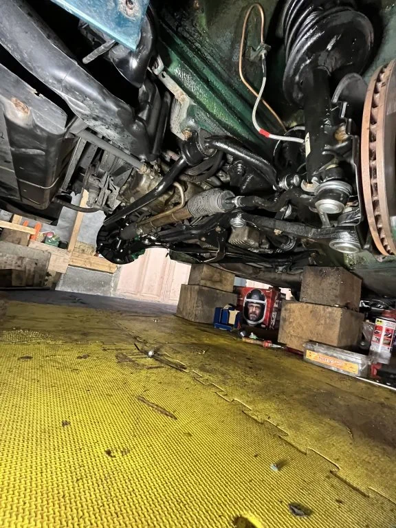

We got the front end stripped now, just waiting for parts to arrive, front brake lines 1st job after a good clean up.

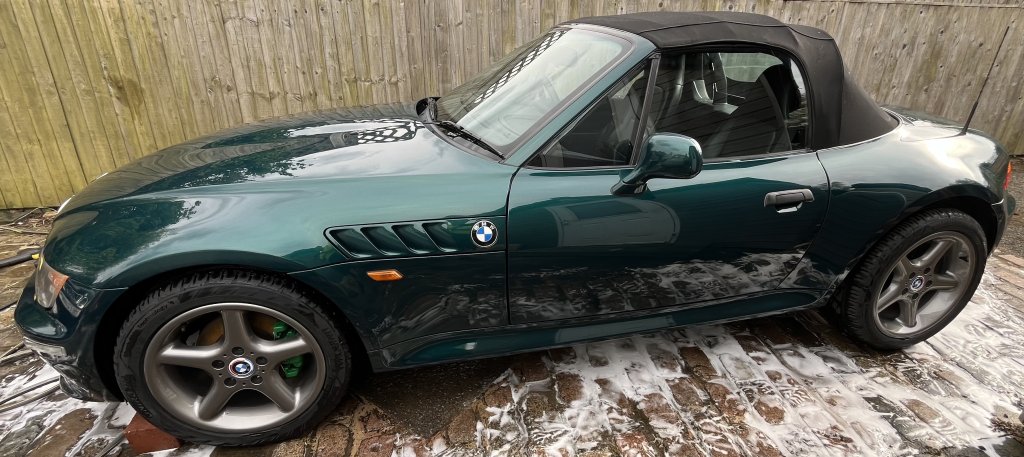

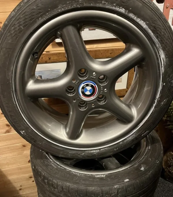

vv54 is that a Black or Gun Metal grey wheels and how does it match up with the Boston Green paint? Pics much appreciated once they are on.
VV54
Feb 19, 2023
24
2.0
Wheels are grey, as soon as the cills are back from paint I’ll put them on the car and add photos, I think they look good with the green car 👍🏼
MuttyMax
Jan 13, 2022
69
Woking, Surrey
1.9 M44 and 2.8
Thanks my daughter wants black on her Boston Green but I’m not convinced….
208
Iain these things are definitely an each to their own kinda thing as we all like different things personally especially with gloss black i always think makes tyres look grey . Anthracite can look nice on the right body colour.
Diamond cut with black can look nice on the right style of wheel but requires maintenance to keep that way.
Colours like purple, blue etc is way to honda civic, vw caddy sideways toting baseball caps 😀 and finally good old silver comes in a multitude of shades and finishes if nothing else cant go wrong whatever body colour but thats just my preference .
