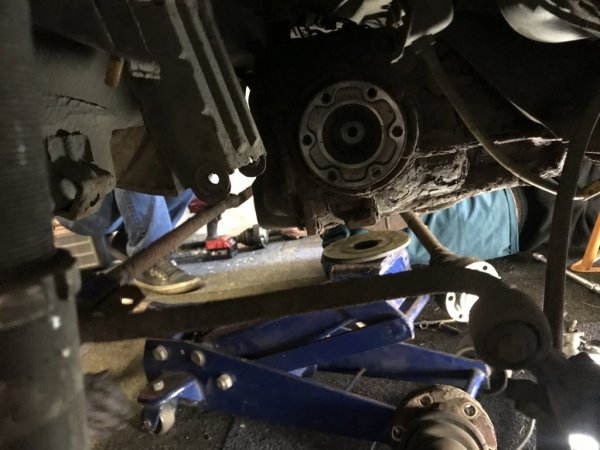

Car raised and the work begins (that work includes swearing, getting covered in amazing amounts of rust, having a laugh and a bit of pain - it’s takes some seriously clever manoeuvring to get the diff out when you don’t have a saggy subframe!):
Extension on extension on extension on extension...you get the idea!:
Gaz thinking ‘how the hell have I ended up back under this old shed?!’:
The now infamous Zedshed footwear standards have been maintained over the years however there is a new sock code to adhere too now
