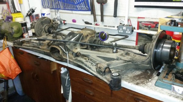

A few more pictures from todays efforts. Lee had already picked up the rear beam from the guys who push out and push in the beam bushes. The guy said these were really hard work as they were really bad.
New Brembo brake discs fitted. These have a nice coating on the hubs so shouldn't rust/discolour quickly. They aren't that much more expensive either.
Shiny new hand brake cables...
New beam bushes close up...
To show the contrast in how a new beam bush act compared the knackered ones earlier in the thread...

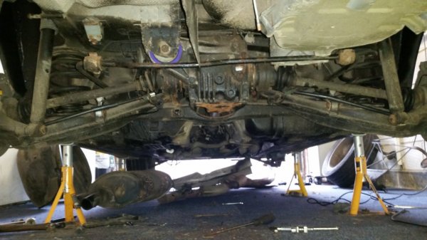

Ready to drop off the bench following a sanity check to make sure everything is correct, fitted and tightened.
Dropped to the floor on top of the trolley jack, now need to manouvre and line everything up and raise it.
Raised nice and smoothly despite not lining up on the prop shaft first time. Everything pretty much reconnected, ARBs and exhaust to go!
