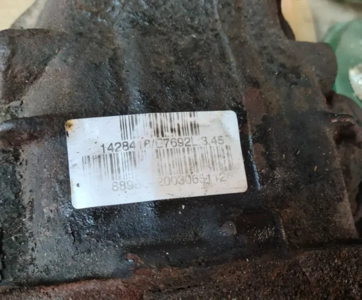

only slightly more positive news... the Diff looks very decent... all this was a soaking in Gunk degreaser... no scrubbing or anything...think it'll come up a treat
oooo forgot to say...It's a 3:45 ratio Diff.. is that usual for a 1.9?
