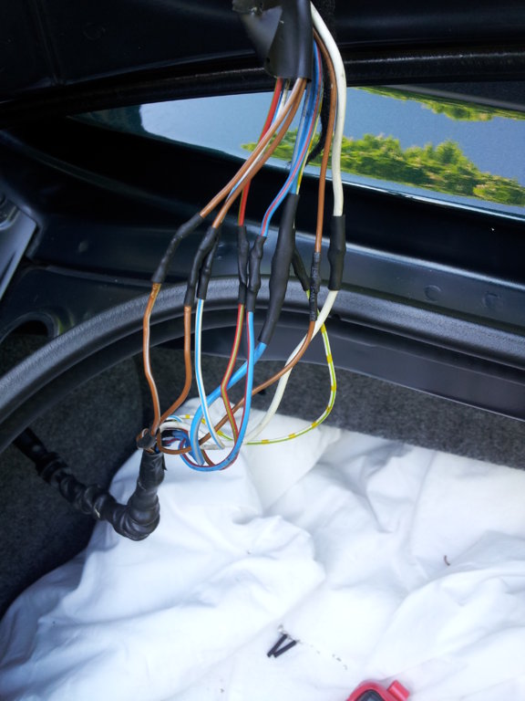

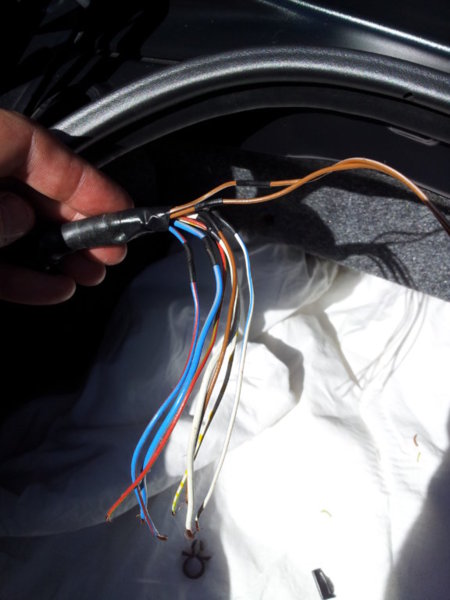

Definitely disconnect your battery ( negative side) . Have some heat shrink tubing to slide on before joining and stagger the joint over a few inches otherwise you will end up with a large bulge of the cable in one place.
