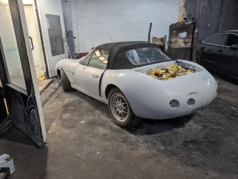

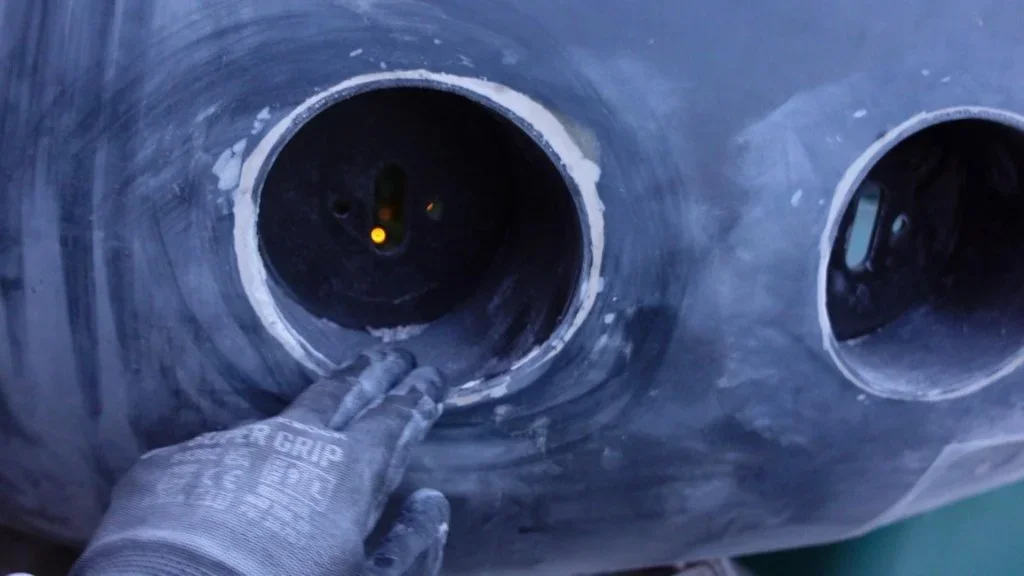

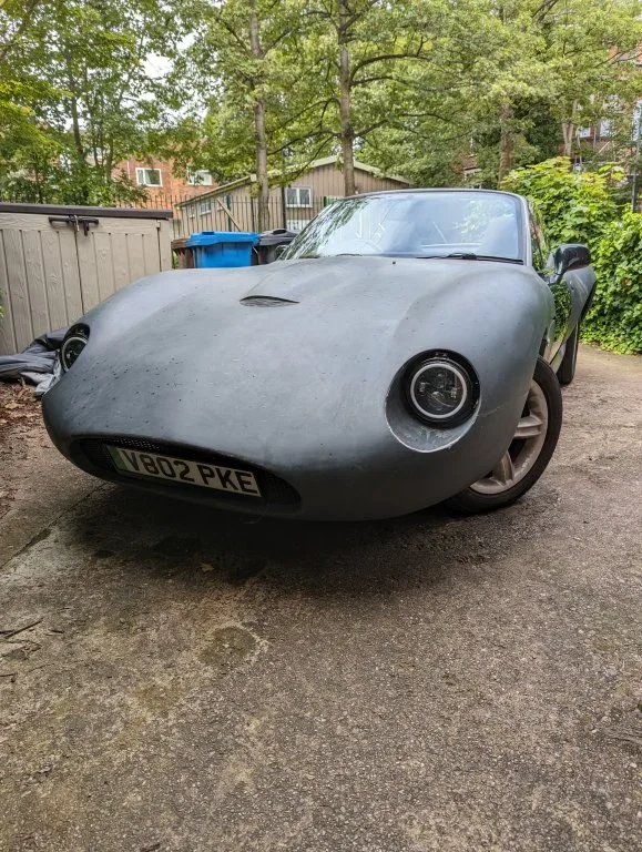

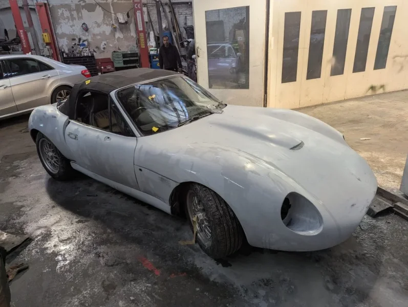

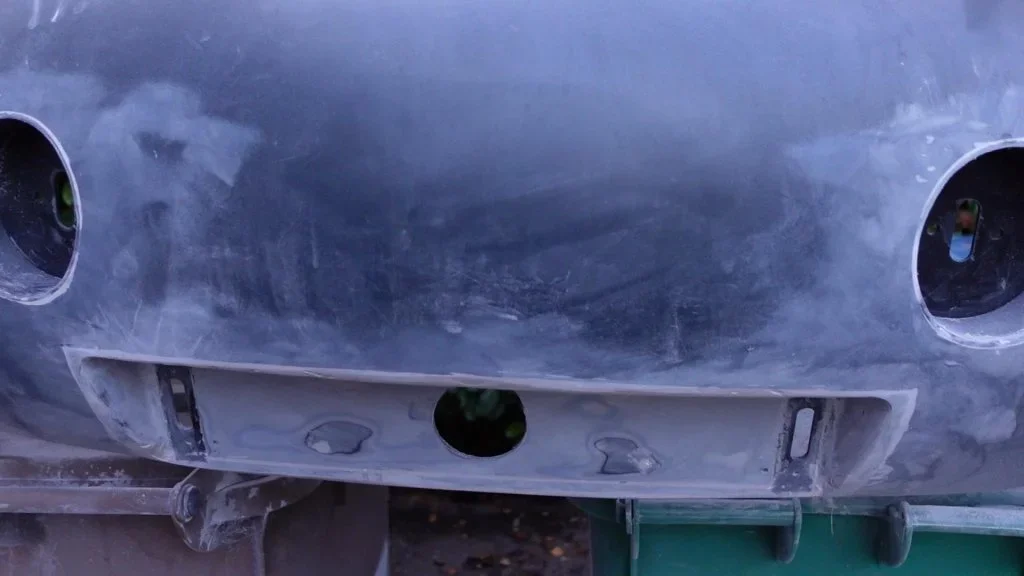

Belated little update: finally getting some bodywork done in the rare dry moments. It's not ideal working in a northern winter without a garage, but I do at least now have a gazebo in the back yard for the bits that I can fit in it/get down the alleyway.
I haven't taken any very good photos so these are stills from the latest/upcoming YouTube vids but main changes are that the rear light buckets are now properly integrated, as is the number plate surround, and I've added material to the back of the door shuts so that I can sand them back for a better fit.
Still a lot of work to do, just on this bit, to get it ready for paint. Sills and winglets can all come to the gazebo to get tarted up. Hard part is going to be the bonnet...

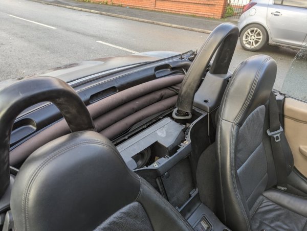

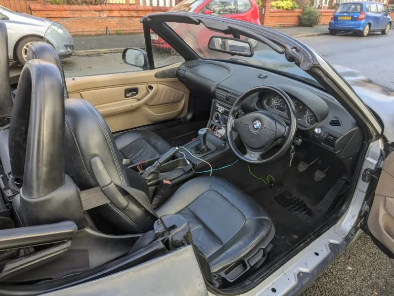

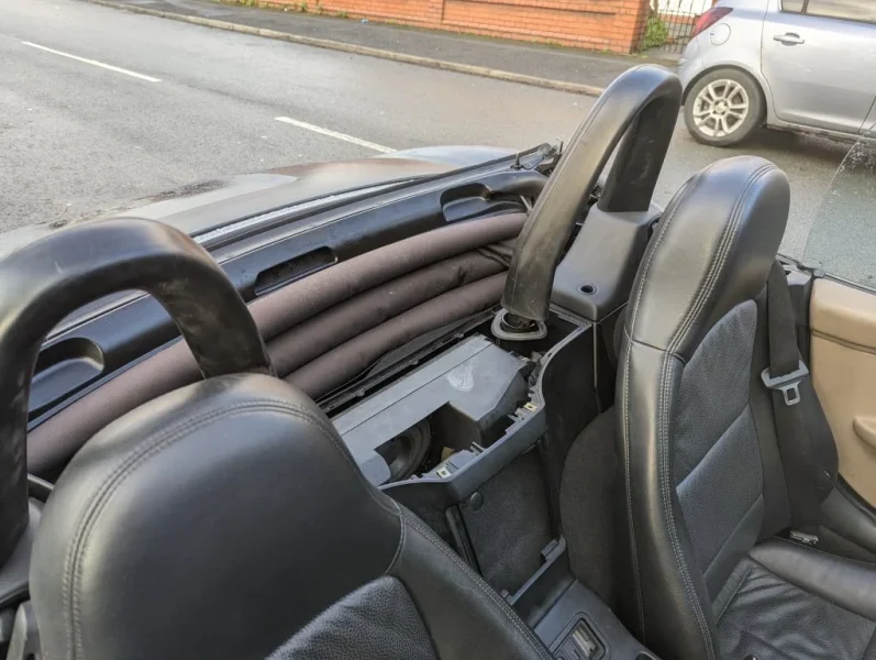

Been putting some time - and money - into the interior while the weather has been too bad for working on the body. Finally fitted the subwoofer I restored (though it's not hooked up yet) and fitted the roll hoops I bought from @IainP (albeit I need to finish up the trim). All in the video that went out tonight.
What's not covered there is an issue I have with my new heated leather seats. My connectors don't seem to match up and I'm wondering if I need to swap in the complete bases from my old cloth ones.

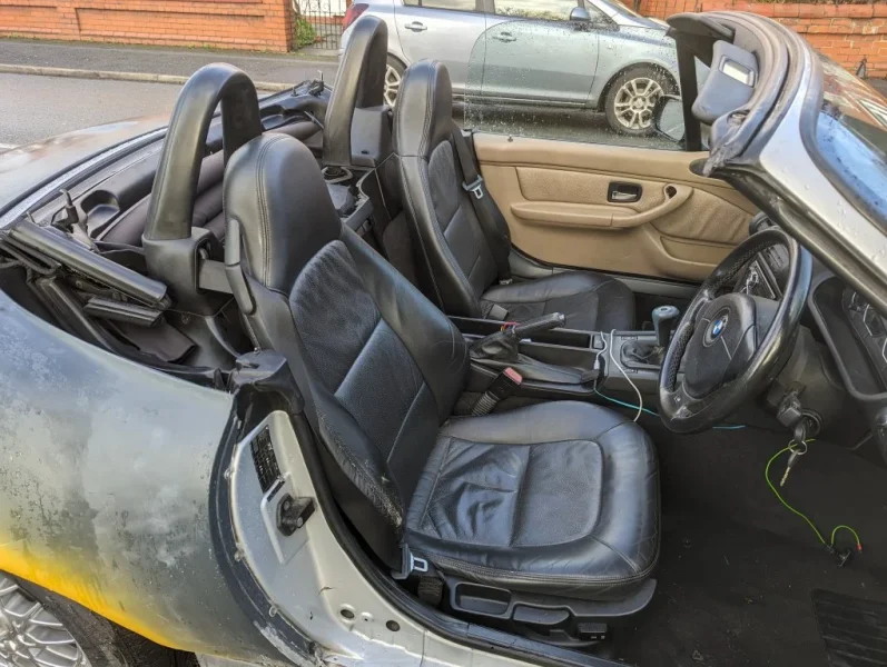

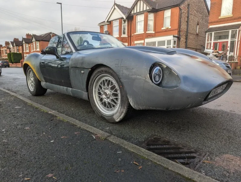

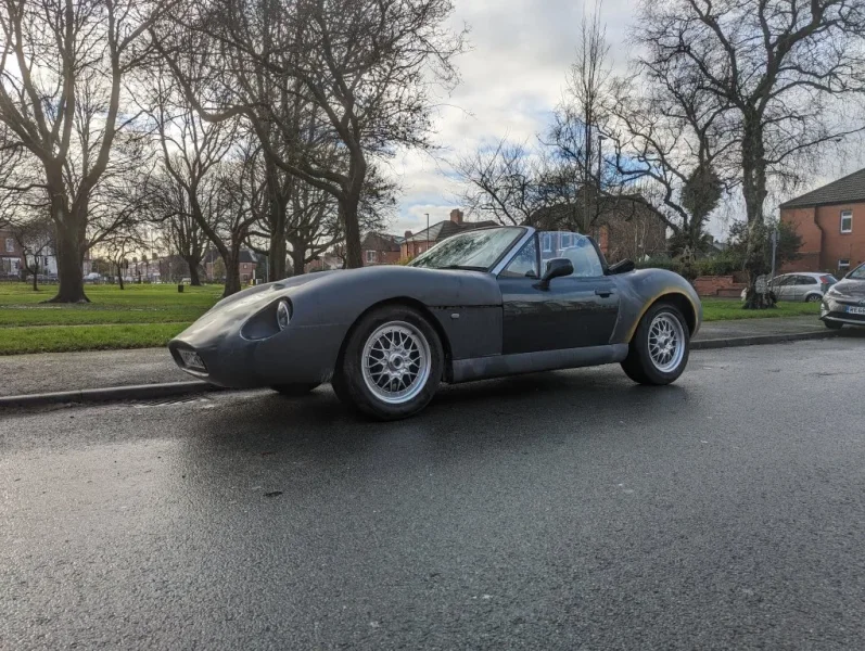

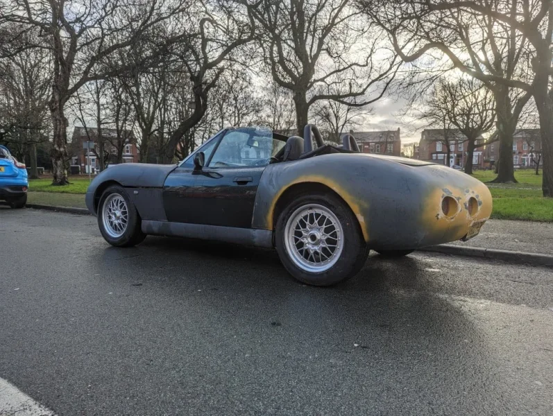

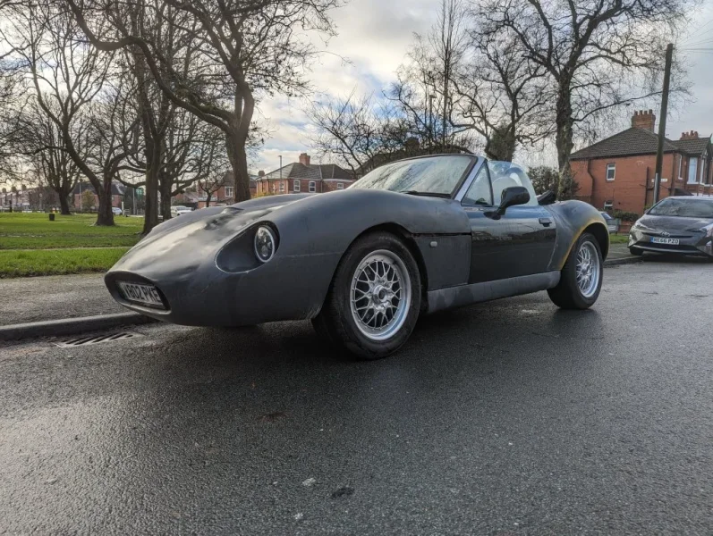

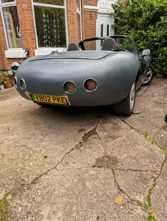

Thought I'd do a quick update with some pics on where I'm up to. Still a long way to go but I'm really happy with how it's looking.
New wheels are on (17in BBS split rims with 235x55 Nexen rubber, all done by Evolution Coatings in Irlam), new seats are repaired and installed (from BMW Spares Scotland - these will be retrimmed at some point), as are repaired/upgraded subwoofer and amp, and roll hoops - need to make a bunch of trim though.
Lots of work still to do on the body when it's dry again. But it's coming along.
