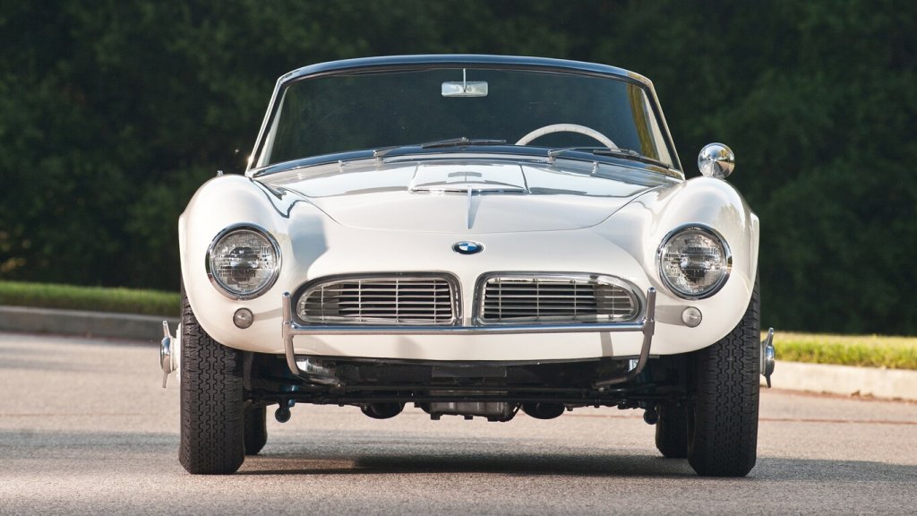

How about this as a different approach to the bumpers, not sure that I like it!

No from me too. Wouldn't look anything like that on the tribute 507 anyway. Tribute has a big valance under the bumper while the real 507 doesn't.

Looks like an explosion in a towel rail factory.
Sorry.
