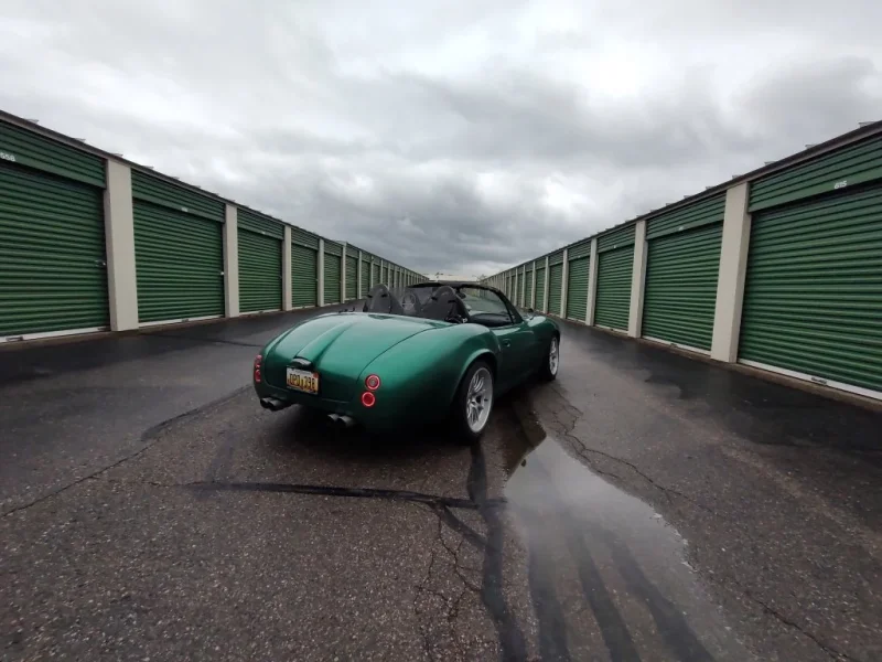

Enjoying the car before I get to wrenching on it (or sanding in this case) again. Took it out for some drives and an autocross! Unfortunately, it was very wet so traction was definitely an issue, but it was still really fun as always.
Here's a fun clip:
View: https://youtu.be/aRKLai1G0zw?si=sKanEeU3LK-kz-Cm
I have a few more videos on instagram if anybody is interested. I'm called "cheever13". I don't really know how to link it here. Anyway....
More updates to come as I work on the paint more, interior, storage space(s) and see what kind of wear and tear I'm looking at.
