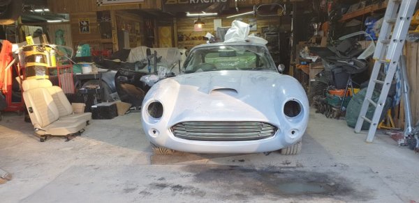

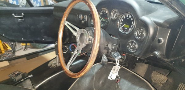

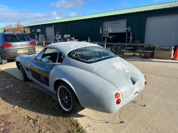

Its a Tribute Automotive ZGT. Here's pictures of the current progress...

I'm building a tribute 507. Doing all the work myself and just doing beam bushes, brakes and suspension. Everything else is oem and ok and I'll fix stuff as and when it's necessary.
But you're having it built by CCW. I don't know what that build costs but, in the big scheme of things, if it was me, I think I'd joining the queue at @Lee ' s shed and have the whole thing refreshed for years of trouble free motoring.
