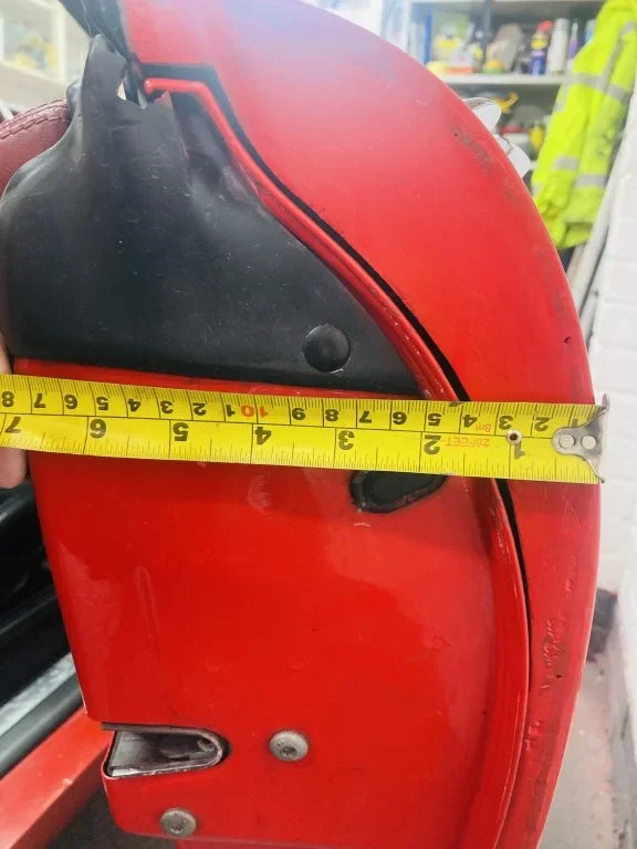

I've got a flat sheet of fibreglass. I'm going to fix it to the door of my Z and guestimate the distance and angle from the steel skin and fit this handle to that 'skin'.
The door handle on the Z3 moves quite easily up to about 45 degrees without anything happening then another cm against some resiistance and the door clicks open. I'm thinking of fitting the handle a bit higher up the door than in my diagram so that there's an even pull at that last bit of resistance.

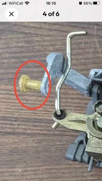

The original handles act on the lock. The bar which operates the lock originally had a plastic sleeve where the red circle is, it’s missing here.
By adding a new tube over this section you remove alot of slack from the handle operation, so the movement you have before it starts working is due to this sleeve having disintegrated and fallen off years ago.

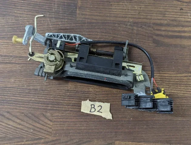

I know I keep harping on about the Z3 deadlocking problem but when they deadlock it is a real problem. For this reason a bear claw or any boot lock that is NOT attached to the central locking is a good idea.
If your car is deadlocked just open the boot with your trusty key and flash your emergency wire to the +ve battery terminal and the car will unlock.

They deadlocking problem happens when you fit the extra door skin. The pin from the new door handle doesn't have much throw so it has to be fitted as close to the push plate as possible.
If the door pin puts any pressure on the opening plate the car will deadlock. The only way to open a deadlocked car is to open it with the door key, if you have a door skin you cannot do this.
If your car doesn't have the extra door skins such as the Kobra you don't have to worry.
The last time mine deadlocked I had to remove the rear window and crawl in but even with the key in the ignition the car would not unlock. Trying to remove the door panels with the doors closed and seats in is a nightmare. You need to gain access to door lock lever that is situated at the back of the door which will involve getting the angle grinder out. Much easier to cut the new gap door skin to gain access to the door lock. Some builders of the 250 left a hole in the skin with a plug to hide it along with an old extended key so the lock could be operated.

This is what happened when I tried using the Alfa handles.

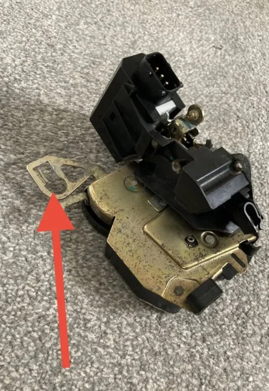

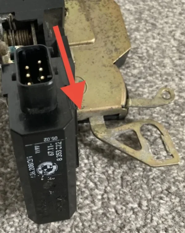

If this lever does not fully retract, the car will not open using the central locking. The Alfa handle had approx 10mm Push which is not enough to allow the lever to go back.
The herald has about 16mm push so works well

That's the bugger, an absolute nightmare to get your fingers to but this is the lever that must be lifted to unlock a deadlocked car.
Can you post a picture of the other side of the lock as it will explain better where this part of the lock is positioned.
