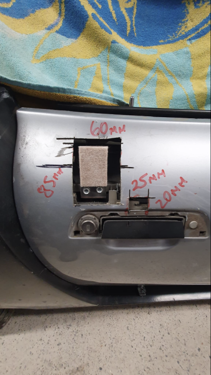

@Dxbolton Can I ask a favour. Looking at your picture where you show the thickness of the door skin. Next time you're by your car would you measure the thickness directly where the original door handle is and then also, maybe an inch above and below. You said you lost a month of your life trying to get an alpha handle working. I'm going to rig up a false skin on my door to attach and fiddle about with various handles. I'm sure I'll lose a month of my life too but I haven't got my kit yet so I have a spare month. Thanks :)

I had removed most of the outer skin and handle so that my external handle was operating the oem mechanism, the oem lever HAS to fully retract to allow the central locking to work. Whilst I could get the handle to open and close, it would not retract enough for the central locking to work.
whilst I use the push button now acting on the original handle which was welded back in place, I rely on the central locking for security.
How often does this fail? I have replaced both solenoids so hopefully I’m good for the next 25 years. The passenger solenoid did fail once so I replaced both sides.
Measuring the skin won’t help as it depends on the handles being used and the angle you fit them to the door.
I tilted my triumph herald handles so the mechanism works smoothly as opposed to a direct fit on the skin

You cut a small hole above the original handle and add a striker plate to the mechanism. The push button hits the striker plate and operates the bmw handle.

That will give you problems. the striker plate you have added is too far away from the push pin on the door handle.
What you need to do is exactly what you have done but on your plate it needs to be bent towards you at 90 degrees. Then another bend of approx 9o degrees downwards. This places the new striker plate much closer to the pin of the door handle so it doesn't need to travel very far before it engages the plate and opens the door. The door handle pin must not touch the plate otherwise the car will deadlock, if it does then hopefully you have run the emergency release wire to the boot so you can touch the battery +ve to un deadlock the car.

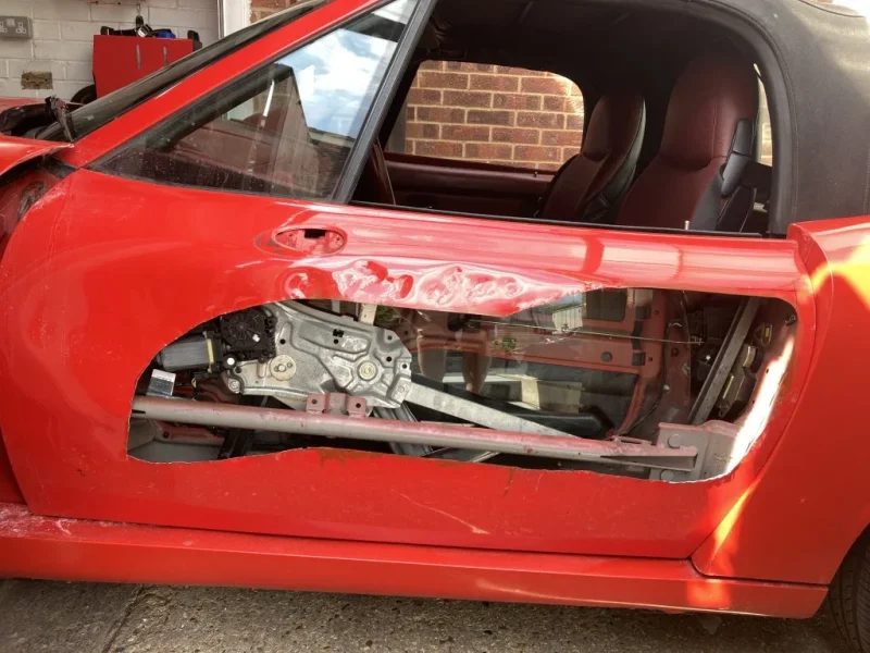

I think I know what you mean. The rod wouldn't be welded/screwed rigid to the z3 handle. It would be attached via a bearing or hinge that allows the rod to swivel. The rod comes out at a fixed angle but as it moves the angle between the rod and Z3 handle can change.
Looking at door from this angle
1. Original Z3 handle in the closed position.
2. Pull the handle out and up to open the door.
3. Red tribute door skin over the door. The grey is a pull handle. Sorry. Not a very good representation but I hope you know what I mean. It's attached via a rod to the original z3 handle.
4. Pull the exterior handle which, in turn, pulls up on the original Z3 handle.
The rod isn't fixed rigid to the Z3 handle. There'd be a roller bearing behind the z3 handle.
