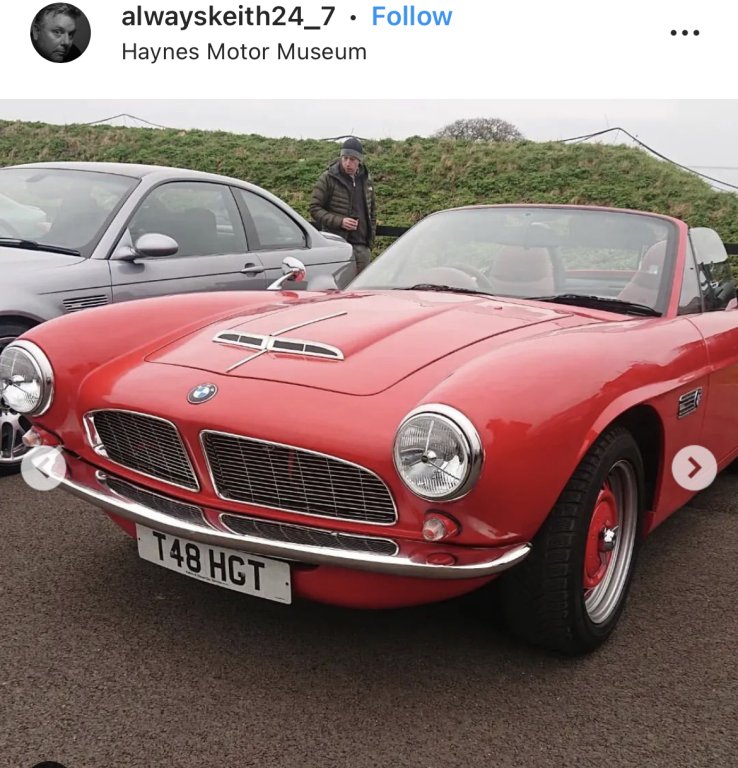

i think that Tribute have nailed this one. having the first off the production line is very cool too. that front valance works very well too.
I am not a fan of the kits with door skins but this one is definitely one that I would very much like to build / own.
well done and see you soon-ish

i think that Tribute have nailed this one. having the first off the production line is very cool too. that front valance works very well too...
+1 from me.
What a super result.

There is now a choice of front valence, this one is deeper to allow for the aircon pipe work and power steering loop to be accommodated.
there is a shallower one for non air-con cars

I like what you have done for the grille on the bonnet - looks good

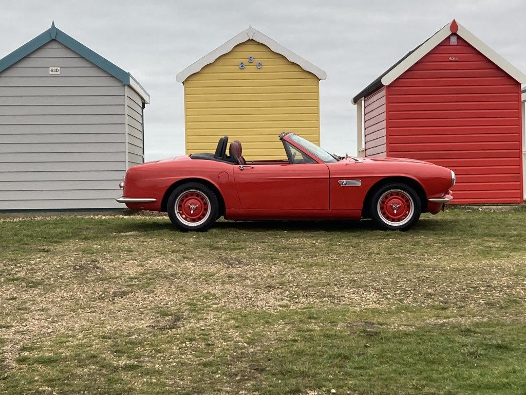

The door handles need to be in that position on both the 507 and the 250 as the operate the original BMW door mechanism. The DNA 250 removed the original door handle and used a pulley with a bowden cable so you could position your door handle a little lower which does look better. However this means there is more to go wrong with it.
I much prefer the Tribute kits with door skins, the extra width (only a couple of inches but the wife says it make all the difference!) give it much more presence.

The original plan was to use Alfa Romeo handles in a lower position.
after 2 months of head scratching the idea was dropped. I could get the door to open and close but there wasnt enough movement to allow the central locking to work. It was VERY close, but wasn’t going to work.
the new door skin is about 30mm away from the original skin so you cannot use the original handles like the Kobra kit. The external handles act on the original mechanism after a small adaption
Door handles are not marked on the skin as there are numerous handle choices. I used triumph herald, but MGB will fit and probably most other push button handle that you could think of,
I have an extended leather bmw interior so it will not be changed, it’s too nice.

Yes, the body is wider, but it’s more the profile is different, I’ll try and take a photo tonight to show this.
I rely on central locking rather than a key which was rarely used before conversion.
I have used BMW winter steel wheels which have a slightly larger offset, but there are so many styles available from modern to retro it’s a choice only you can make depending on the cars style
