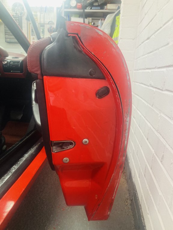

When the door skin is attached what's in the gap. Air? Padding?
I'm wondering if I could leave the original handle in place and rig up a period looking handle on the outer skin that, when pulled, just pulled the original handle underneath. A rod bolted on to the original handle. So the original flap handle is still being pulled and no messing about with the inner workings of the mechanism.
I would need to figure out some way to unlock if ever the central locking packed up (again) though.
The new skin overlaps the original and is secured by screws and brackets on the lower edge. I will close the gap tighter between the two skins in the next few months so it’s a tight fit.
Krähental
The new skin overlaps the original and is secured by screws and brackets on the lower edge. I will close the gap tighter between the two skins in the next few months so it’s a tight fit. View attachment 275867
Thank you for the photo.

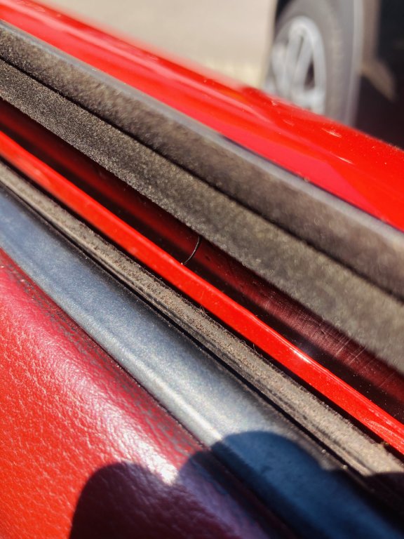

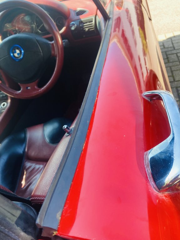

@Dxbolton Thank you. I must confess I was a bit worried when you said there was a 30mm gap between the door and skin. But your pictures explain it. Thanks.
No hurry. But next time you're by the car would you take a picture looking down on the door. I'm curious about how it attaches at the top. Sounds like it hooks over the top in place of the rubber trim? Does the kit require a different trim?

You remove the original rubber window seal, and the skin drops into the groove that it leaves.
I have reused the original seal on the new skin and it fits well. I had to modify the end slightly but it’s only Minor.
I’ll get photos soon

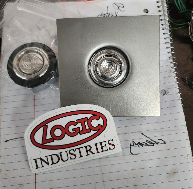

Finding a handle that PULLS up would be the hard part.
the push button down onto the original handle is tried, tested, and works well,
American Lincoln door push buttons would look good, with poppers, to push open the door.
Some “kit” car builders fit a small push button switch in the bottom of the mirror casing to release the door lock. I used a similar thing as a boot popper on my old Mazda Euros using a solenoid from an aftermarket central locking kit. You could do the same?
