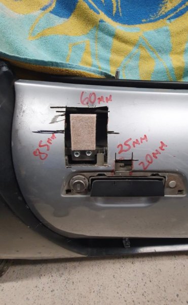

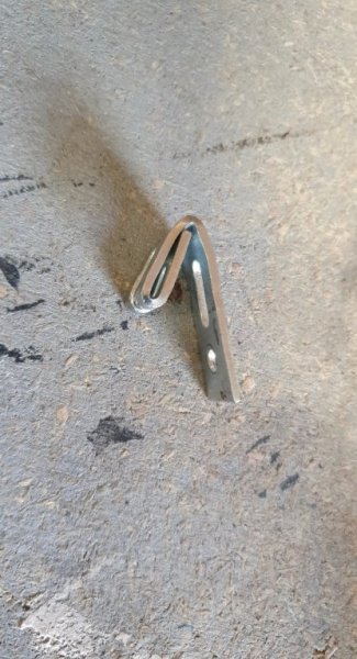

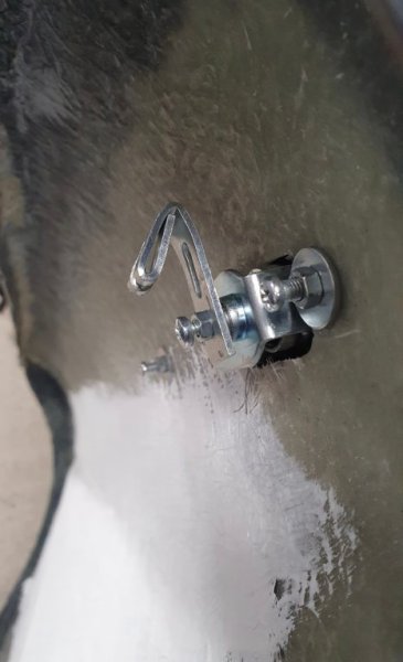

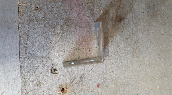

I started with Chris's original cut outs and made them bigger to suit my needs. Having a larger plate meant that it was easier to lower the mini handle and fit a bracket on the plungerto hit the pivot point higher.
Started off with a 65mm L bracket and bent it over.
The small cut out above the handle is to release the zed handle spring which releases the tension.
Handle operation us really easy now.
All of the cuts were made without having to remove the original zed handle. You'll need to remove the plastic trim around the handle hough. Blunt chisel will do this.

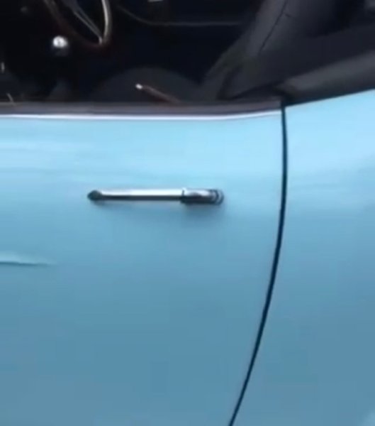

I had originally thought of mgb ones as they're relatively cheap brand new and no key to worry about......not that I'm using the key on my mini ones. I just prefer the feel and shape of the mini ones.
Pic of an mgb one for reference.
I used self adhesive felt pads on the pivot plate to soften the sound of metal on metal when opening the door. Think I got them in b and q (floor protectors for furniture feet).

Those door handles are very low. What mechanism of L brackets or whatever did Chris use to get them that low? I don't want mine that low but would be interested in knowing how that was done.
BTW. That blue door with the MGB handle. Are they a forum member? Any links to pics of their car?

I don't think the guy with the blue one is a member.....plus he might not be happy that I've taken a screenshot of his handles.
